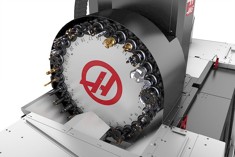

  • 30+1 Side-Mount Tool Changer, 50-Taper

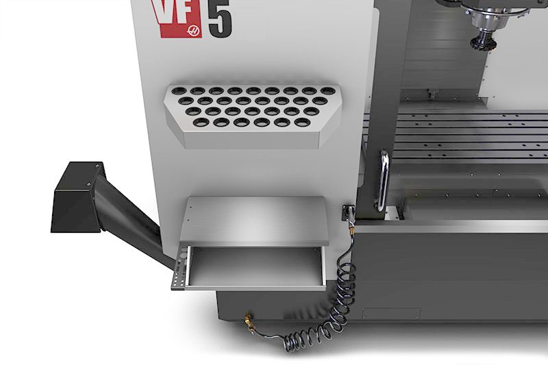

  • Chip Auger

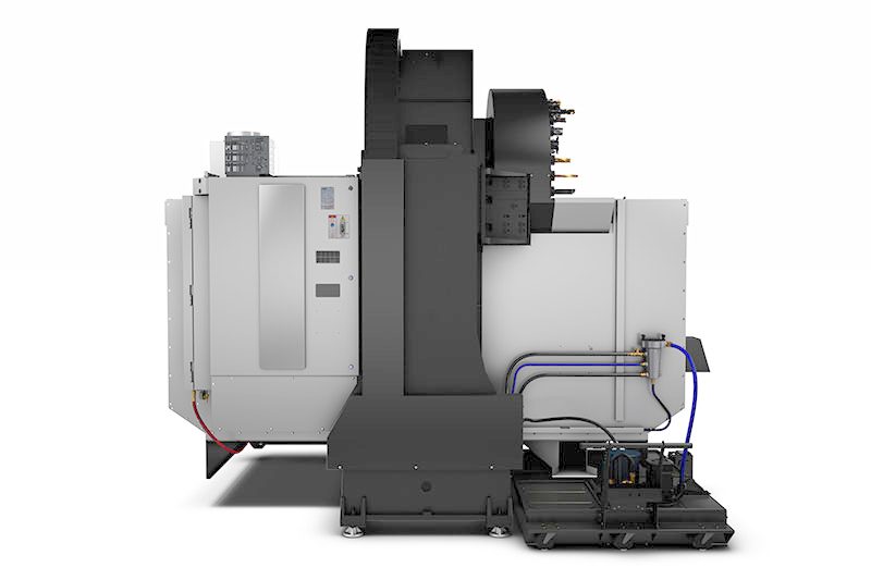

  • 95-Gallon Coolant Tank
  • Multi-Stage Coolant Pump

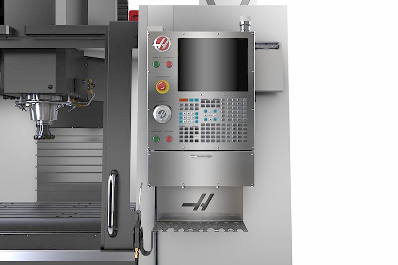

  • Control Widescreen Monitor
  • Large Remote Jog Handle with Touchscreen Display

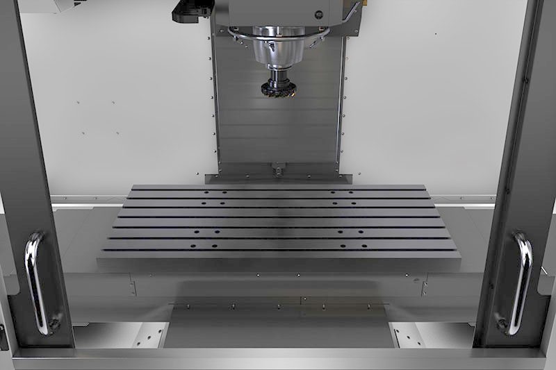

Table S.A.E METRIC
Length 54.0 in 1372 mm
Width 24.0 in 610 mm
T-Slot Width 0.626 in to 0.630 in 15.90 mm to 16.00 mm
T-Slot Center Distance 3.15 in 80 mm
Number of Std T-Slots 7 7
Max Weight on Table (evenly distributed) 4000 lb 1814 kg
