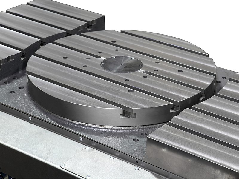

This full 4th-axis platter integrated into the table provides fully interpolated motion for contouring and positioning of large parts. Platter diameter is 30" (762 mm), with a 10,000 lb (4536 kg) weight capacity. This option is not field-installable.
  • 4000 lb brake torque
  • 2000 lb continuous rotational torque
  • 0.001 degree resolution
