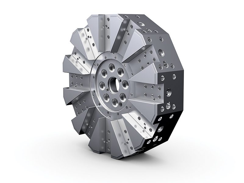

This 12-Station Bolt-On Tool Turret accepts 1.25" (32 mm) turning sticks on the face, and uses industry-standard bolt-on toolholders (105 mm x 70 mm bolt pattern) around the turret OD.
  • Turning sticks can be mounted on either side of tool pocket to allow for right- or left-hand tools
  • Wedge-style clamping secures turning sticks in tool pockets
  • Boring bar toolholders can bolt to the outside diameter of the turret
  • Industry-standard 105 mm x  70 mm bolt pattern for greater aftermarket holder availability
