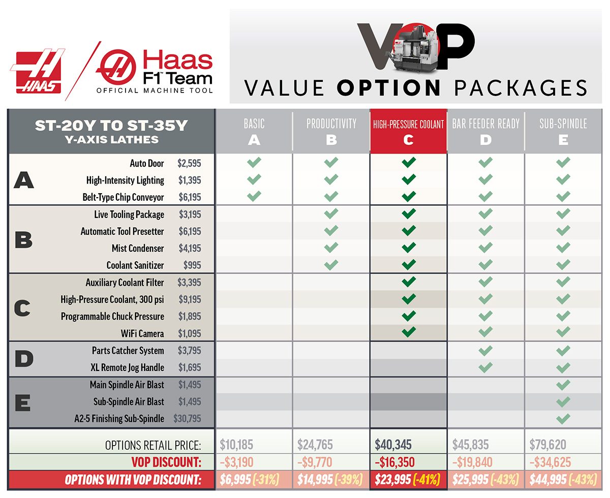

Our Value Option Package-C for ST-20Y through ST-35Y models includes everything in Packages A and B, and adds an auxiliary coolant filter, high-pressure coolant, programmable chuck pressure, and WiFi Camara.
Package A: Includes an auto door to reduce operator fatique, and open the door for future automation; high-intensity lighting to brighten your machine’s workspace; and a belt-type chip conveyor to efficiently remove chips from the enclosure.
Package B: The 6000-rpm live tooling upgrade increases the maximum speed of the driven tools from 4000 rpm to 6000 rpm, allowing higher surface feeds and reducing cycle times. The automatic tool presetter increases part accuracy and setup consistency, while reducing setup times by up to 50%. The system features easy-to-use automatic and manual modes of operation. The coolant maintenance package keeps your coolant system filled and free of tramp oil, and the coolant sanitizer reduces bacteria and nasty smells.
Package C: The auxiliary coolant filter is a bag-style filtration system that keeps the coolant free of particulates down to 25 microns. The high-pressure coolant system provides 300 psi (21 bar) of coolant coolant to the cutting too for heavier cuts, higher feedrates, deep-hole drilling, and better surface finishes. The programmable chuck pressure option allows you to control the gripping force of the hydraulic chuck via the part program, or directly from the Haas control. The WiFi camera allows you to keep an eye on your machining processes remotely.
Package Includes:
  • Auto Door
  • High-Intensity Lighting
  • Belt-Type Chip Conveyor
  • 6000-rpm Live Tooling Upgrade
  • Automatic Tool Presetter
  • Coolant Maintenance Package
  • Coolant Sanitizer
  • Auxiliary Coolant Filter
  • High-Pressure Coolant
  • Programmable Chuck Pressure
  • WiFi Camera
