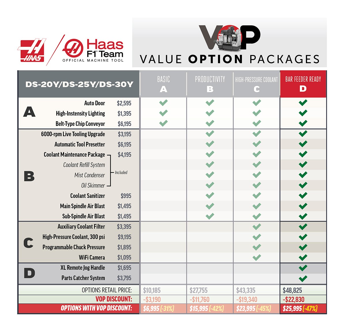

Our Value Option Package-D for the DS-30Y includes everything in Packages A, B, and C, and adds an automatic parts catcher and extra-large remote jog handle.
Package A: Includes an auto door to reduce operator fatique, and open the door for future automation; high-intensity lighting to brighten your machine’s workspace; and a belt-type chip conveyor to efficiently remove chips from the enclosure.
Package B: The 6000-rpm live tooling upgrade increases the maximum speed of the driven tools from 4000 rpm to 6000 rpm, allowing higher surface feeds and reducing cycle times. The automatic tool presetter increases part accuracy and setup consistency, while reducing setup times by up to 50%. The system features easy-to-use automatic and manual modes of operation. The coolant maintenance package keeps your coolant system filled and free of tramp oil, and the coolant sanitizer reduces bacteria and nasty smells. The main spindle air blast and sub-spindle air blast keep your workpiece and/or workholding clear of chips, without having to open the operator door. Activated by M-code, the air blast can be programmed to activate while the spindle is turning, at the end of cycle, or before a part pass-off to the sub-spindle.
Package C: The auxiliary coolant filter is a bag-style filtration system that keeps the coolant free of particulates down to 25 microns. The high-pressure coolant system provides 300 psi (21 bar) of coolant coolant to the cutting too for heavier cuts, higher feedrates, deep-hole drilling, and better surface finishes. The programmable chuck pressure option allows you to control the gripping force of the hydraulic chuck via the part program, or directly from the Haas control. The WiFi camera allows you to keep an eye on your machining processes remotely.
Package D: Our two-stage automatic parts catcher moves completely out of the primary work envelope during machining, and quickly moves into place when commanded at the end of cycle. For parts with short cycle times, the arm can be left in the extended position, with only the tray rotating up to catch parts at the end of cycle. The extra-large remote jog handle with touchscreen display lets you get up-close to the machine’s work area for part setup, changeover, and inspection, while still having control of the machine.
Package Includes:
  • Auto Door
  • High-Intensity Lighting
  • Belt-Type Chip Conveyor
  • 6000-rpm Live Tooling Upgrade
  • Automatic Tool Presetter
  • Coolant Maintenance Package
  • Coolant Sanitizer
  • Main Spindle Air Blast
  • Sub-Spindle Air Blast
  • Auxiliary Coolant Filter
  • High-Pressure Coolant
  • Programmable Chuck Pressure
  • WiFi Camera.
  • Parts Catcher System
  • XL Remote Jog Handle
