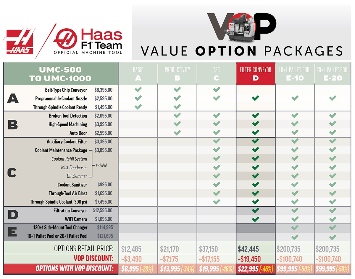

Our Value Option Package-D for UMC-500 through UMC-1000 models (non SS) includes everything in Packages A, B, and C, but replaces the standard chip conveyor with a filtration conveyor, and adds a WiFi camera.
Package A: Includes a programmable coolant nozzle to ensure coolant gets where it’s needed.
Package B: Broken tool detection uses a built-in camera to determine if a tool gets damaged during machining. The high-speed machining option enables higher feedrates and more complex toolpaths without hesitation. The auto door reduces operator fatique, and opens the door for future automation.
Package C: The auxiliary coolant filter is a bag-style filtration system that keeps the coolant free of particulates down to 25 microns. The coolant maintenance package keeps your coolant system filled and free of tramp oil, and the coolant sanitizer reduces bacteria and nasty smells. Through-tool air blast and through-spindle coolant deliver high-pressure/high-flow air or coolant through the tool, directly to the cutting edge. You can easily switch between air and coolant through the tool, depending on the application.
Package D: The filtration conveyor efficiently removes chips from the enclosure, while filtering the coolant to reduce the accumulation of chips in the coolant tank. The WiFi camera allows you to keep an eye on your machining processes remotely.
Package Includes:
  • Programmable Coolant Nozzle
  • Broken Tool Detection
  • High-Speed Machining
  • Auto Door
  • Auxiliary Coolant Filter
  • Coolant Maintenance package
  • Coolant Sanitizer
  • Through-Tool Air Blast
  • Through-Spindle Coolant, 300 psi (21 bar)
  • Filter Conveyor
  • WiFi Camera
