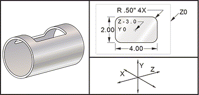

* indicates optionalG107 DescriptionThree address codes can follow a G107: Y, C, Q or R.Enable G107 mode with Y-axis as linear and C-axis as rotary axis. If address code R or Q is not specified, an alarm is generated.
G107R/Q; change the radius of the mapping cylinder.
G107; Disables the G107 mode.
NOTE: G107 should only be used in G19 plane. Do not change to the G17 or G18 plane while G107 is active.
Cylindrical Mapping Example
The following program O00555 use I,J and K for the arc center point for the 0.500" radius in the corners. Program O00556 uses the R in place of the I,J and K for the arc center points.
%O00555 (G107 CYLINDRICAL MAPPING);
T1717;
M133 P500;
G00 X4.2 Z1.;
Z-3.;
G98;
M15;
G107 Y0 C0 Q4.;
G01 X3.5 F40.;
G01 G41 Y-1.;
Z-4.5;
G03 Z-5. Y-0.5 J0.5;
G01 Y0.5;
G03 Z-4.5 Y1. K0.5;
G01 Z-1.5;
G03 Y0.5 Z-1. J-0.5;
G01 Y-0.5;
G03 Y-1. Z-1.5 K-0.5;
G01 Z-3.;
G01 G40 Y0;
G00 X4.2;
G107;
Z1.;
G28;
M30;
%O00556 (G107 CYLINDRICAL MAPPING R);
T1717;
M133 P500;
G00 X4.2 Z1.;
Z-3.;
G98;
M15;
G107 Y0 C0 Q4.;
G01 X3.965 F40.;
G01 G41 Y-1.;Z-4.5;
G03 Z-5. Y-0.5 R0.5;
G01 Y0.5;
G03 Z-4.5 Y1. R0.5;
G01 Z-1.5;
G03 Y0.5 Z-1. R0.5;
G01 Y-0.5;
G03 Y-1. Z-1.5 R0.5;
G01 Z-3.;
G01 G40 Y0;
G00 X4.2;
G107;
Z1.;
G28;
M30;%
