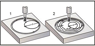

G12 Circular Pocket Milling CW / G13 Circular Pocket Milling CCW (Group 00)
These G-codes mill circular shapes. They are different only in that G12 uses a clockwise direction and G13 uses a counterclockwise direction. Both G-codes use the default XY circular plane (G17) and imply the use of G42 (cutter compensation) for G12 and G41 for G13. G12 and G13 are non-modal.
NOTE: For lathe machines, G17 and G268 are the only planes that G12/G13 can be used.
*D - Tool radius or diameter selection**
F - Feedrate
I - Radius of first circle (or finish if no K). I value must be greater than Tool Radius, but less than K value.
*K - Radius of finished circle (if specified)
*L - Loop count for repeating deeper cuts
*Q - Radius increment, or stepover (must be used with K)
X - Depth of cut or increment
*indicates optional**To get the programmed circle diameter, the control uses the selected D code tool size. To program tool centerline select D0.Rapid-position the tool to the center of the circle. To remove all the material inside the circle, use I and Q values less than the tool diameter and a K value equal to the circle radius. To cut a circle radius only, use an I value set to the radius and no K or Q value.Circular Pocket Milling, G12 Clockwise shown: [1] I only, [2] I, K and Q only.
These G codes assume cutter compensation, so you do not need to program G41 or G42 in the program block.
NOTE: For lathe machines, G12 and G13 will automatically engage the C axis.
These program example shows the G12 and G13 format, and the different ways that you can write these programs.Single Pass: Use I only.Applications: One-pass counter boring; rough and finish pocketing of smaller holes, ID cutting of O-ring grooves.Multiple Pass: Use I, K, and Q.Applications: Multiple-pass counter boring; rough and finish pocketing of large holes with cutter overlap.Multiple Z-Depth Pass: Using I only, or I, K, and Q (G91 and L may also be used).Applications: Deep rough and finish pocketing.The previous figures show the tool path during the pocket milling G-codes.Example G13 multiple-pass using I, K, Q, L, and G91:This program uses G91 and an L count of 4, so this cycle will execute a total of four times. The X depth increment is 0.500. This is multiplied by the L count, making the total depth of this hole 2.000.The G91 and L count can also be used in a G13I only line.
