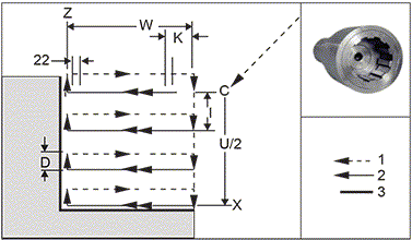

G156 Broaching Canned Cycle: [1] Rapid, [2] Feed, [3] Programmed Path, [C] Clearance Point, [K] Peck ,[22] Peck retraction (Setting 22).
Broaching operations canned cycle can be done using a single tool path (with adjustable programmable Pecks) when using a special broaching shape tool.
Spindle orient command M19P/R code which used to position the spindle before broaching must be used first before executing G156 broaching canned cycle.
NOTE
M19 , P , or R should not be on the same line as G156 . M19 , P , or R value should not be negative. See M19 for more information.
When K is added to a G156 block, then pecking will be performed at each interval specified by K.
The D code can be used for grooving and turning to provide material clearance when returning to starting plane S.
The D code command is used to provide a tool clearance shift, in the X-axis before returning in the Z-axis to the "C" clearance point.
When an X/U, or Y/V code is added to a G156 block and the current (i.e. actual) X/U, Y/V axes machine position not at the position defined by G156X/U, Y/V, then a minimum of two pecking canned cycles will occur, one at the current (actual) location of the machine X/U, Y/V axes, and another one at the X/U, Y/V location set by G156.
The I code is the incremental distance (slices cycle) between the start position S toward the target X/U, Y/V Axes positions (i.e. the thickness of each slice).
Adding an I will performs multiple, evenly spaced, slice cycles between the starting position S and X/U, Y/V Axes target position.
When the distance between S and target X/U, Y/V is not evenly divisible by I, then the last interval is less than I.
The spindles shall be positioned first (Main/Sup spindle) by either having the C-axis engaged (For Main spindle) or spindle to be oriented (Main/Sub) before staring the broach cycle.

The broaching canned cycle is a modal, and it shall be repeated on each line within the canned cycle uses any broaching address code. Refer to examples below:
