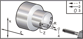

G95, G186 Live Tooling Rigid Tapping: [1] Rapid, [2] Feed, [3] Start or end of stroke, [4] Starting plane, [R] R plane, [Z] Position of the bottom of the hole.
It is not necessary to start the spindle CW before this canned cycle; the control does this automatically. See G84.
