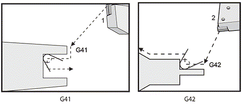

G41 Tool Nose Compensation (TNC) Left / G42 TNC Right (Group 07)
G41 or G42 will select tool nose compensation. G41 moves the tool to the left of the programmed path to compensate for the size of a tool and vice versa for G42. A tool offset must be selected with a Tnnxx code. where xx corresponds to the offsets that are to be used with the tool. For more information, see Tool Nose Compensation in the Operation section of this manual.G41 TNC Right and G42 TNC Left: [1] Tip = 2, [2] Tip = 3.
