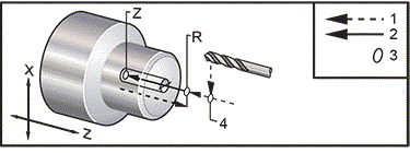

Service Home G81 Drill Canned Cycle (Group 09)
*C - C-Axis absolute motion command (optional)
F - Feed Rate
*L - Number of repeats
R - Position of the R plane
*X - X-axis motion command
*Y - Y-axis absolute motion command
Z - Position of bottom of hole
* indicated optionalAlso see G241 for radial drilling and G195/G196 for radial tapping with live tooling.G81 Drill Canned Cycle: [1] Rapid, [2] Feed, [3] Start or end of stroke, [4] Starting plane, [R] R plane, [Z] Position at the bottom of the hole.
