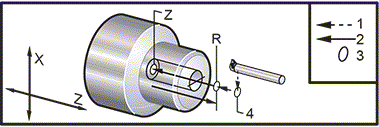

Service Home G85 Boring Canned Cycle (Group 09)
NOTE: This cycle feeds in and feeds out.
F - Feed Rate
*L - Number of repeats
*R - Position of the R plane
*X - X-axis motion command
*Y - Y-axis motion command
Z - Position of bottom of hole
* indicates optionalG85 Boring Canned Cycle: [1] Rapid, [2] Feed, [3] Start or end of stroke, [4] Starting plane, [R] R plane, [Z] Position of the bottom of the hole.
