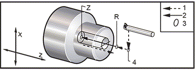

This G code stops the spindle once the tool reaches the bottom of the hole. The tool retracts once the spindle has stopped.
G86 Bore and Stop Canned Cycle: [1] Rapid, [2] Feed, [3] Start or end of stroke, [4] Starting plane, [R] R plane, [Z] Position of the bottom of the hole.
