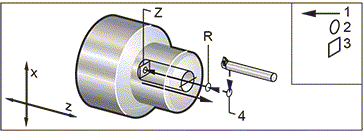

This cycle feeds in and feeds out.
F - Feed Rate
* L - Number of repeats
* P - The dwell time at the bottom of the hole
* R - Position of the R plane
* X - X-axis motion command
* Y - Y-axis motion command
Z - Position of bottom of hole
* indicates optional
NOTE
The P values are modal. This means if you are in the middle of a canned cycle and a G04 Pnn or an M97 Pnn is used the P value will be used for the dwell / subprogram as well as the canned cycle.
G89 Bore and Dwell Canned Cycle: [1] Feed, [2] Start or end of stroke, [3] Dwell, [4] Starting plane, [R] R plane, [Z] Position of the bottom of the hole.
