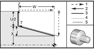

Service Home G90 O.D./I.D. Turning Cycle (Group 01)
F( E) - Feed rate
* I - Optional distance and direction of X Axis taper, radius
* U - X-axis incremental distance to target, diameter
* W - Z-axis incremental distance to target
X - X-axis absolute location of target
Z - Z-axis absolute location of target
*indicates optional
G90 O.D./I.D. Turning Cycle: [1] Rapid, [2] Feed, [3] Programmed path, [4] Cut allowance, [5] Finish allowance, [6] Start position, [7] Target.
G90 is used for simple turning, however, multiple passes are possible by specifying the X locations of additional passes.
Straight turning cuts are made by specifying X, Z and F. By adding an I value, a taper cut is made. The amount of taper is referenced from the target. That is, I is added to the value of X at the target.
Any of the four ZX quadrants can be programmed using U, W, X, and Z; the taper is positive or negative. The following figure gives a few examples of the values required for machining in each of the four quadrants.
G90- G92 Address Relationships
