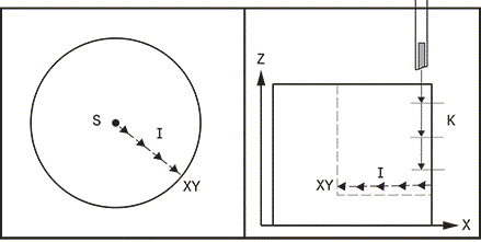

G156 Broaching Canned Cycle: [S] Start position, [I] Slices, [K] Pecks.

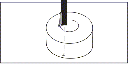

Broaching operations canned cycle can be done on Inner and outer grooves in different position using the G156 code with an optional address codes which define the tool Pecks and the cut paths.
Broaching operations canned cycle can be done using a single tool path (with adjustable programmable Pecks) when using a special broaching shape tool.
Spindle orient command M19P/R code which used to position the spindle before broaching must be used first before executing G156 broaching canned cycle.

When K is added to a G156 block, then pecking will be performed at each interval specified by K.
The D code can be used for grooving and turning to provide material clearance when returning to starting plane S.
The D code command is used to provide a tool clearance shift, in the X-axis before returning in the Z-axis to the "C" clearance point.
When an X, or Y code is added to a G156 block and the current (i.e. actual) X, Y-axis machine position not at the position defined by G156 X or Y, then a minimum of two pecking canned cycles will occur, one at the current (actual) location of the machine X Y-axis, and another one at the XY location set by G156.
The I code is the incremental distance (slices cycle) between the start position S toward the target X/Y Axes positions (i.e. the thickness of each slice).
Adding an I will performs multiple, evenly spaced, slice cycles between the starting position S and X/Y target position.
When the distance between S and target X/Y is not evenly divisible by I, then the last interval is less than I.
The tool clearance shift direction (i.e. shift in + X or - X, ZX plane,) will be depend on the sign of the D value (Positive/Negative).
When the D has a positive value, the tool moves in the positive direction of the X-axis.
When the D has a negative value, the tool moves further in the negative direction of the X-axis.
When D has a zero value or it not specified with the G156 lathe broaching canned cycle, then there shall be no tool clearance shift in the X-axis before returning in the Z-axis to the "C" clearance point.I.e. the tool returning in the Z axis to the "C" clearance point will use the same peck path in the opposite direction.
