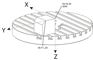

The conceptual example and illustrations in this section represent a line segment from a full 4- or 5-axis program.
NOTE
For clarity, the illustrations in this section do not depict workholding. Also, as conceptual, representative drawings, they are not to scale and may not depict the exact axis motion described in the text.
The straight line edge highlighted in is defined by point (X0, Y0, Z0) and point (X0, Y-1., Z0). Movement along the Y Axis is all that is required for the machine to create this edge. The location of the workpiece is defined by work offset G54.
Location of Workpiece Defined by G54
