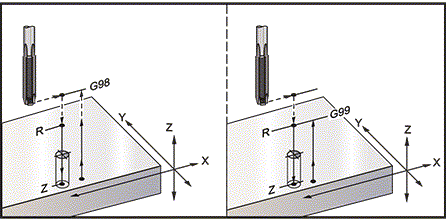

F - Feedrate. Use the formula described in the canned cycle introduction to calculate feedrate and spindle speed.
* J - Retract Multiple (How fast to retract - see Setting 130)
* L - Number of loops (How many holes to tap) if G91 (Incremental Mode) is used
* R - Position of the R plane (position above the part) where tapping starts
* X - X-Axis location of hole
* Y - Y-Axis location of hole
* Q - Peck Depth (always incremental)
Z - Position of the Z-Axis at the bottom of hole
*indicates optional
G74 Tapping Canned Cycle
