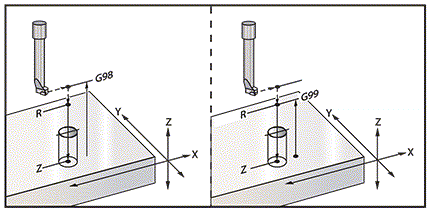

Service Home G85 Bore In, Bore Out Canned Cycle (Group 09)
F - Feedrate
* L - Number of holes if G91 (Incremental Mode) is used
* R - Position of the R plane (position above the part)
* X - X-Axis location of holes
* Y - Y-Axis location of holes
Z - Position of the Z Axis at the bottom of hole
* indicates optional
G85 Boring Canned Cycle
