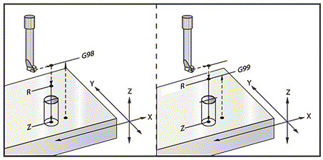

Service Home G86 Bore and Stop Canned Cycle (Group 09)
F - Feedrate
* L - Number of holes if G91 (Incremental Mode) is used
* R - Position of the R plane (position above the part)
* X - X-Axis location of hole
* Y - Y-Axis location of hole
Z - Position of the Z Axis at the bottom of hole
* indicates optional
CAUTION
Unless you specify otherwise, this canned cycle uses the most recently commanded spindle direction ( M03 , M04 , or M05 ). If the program did not specify a spindle direction before it commands this canned cycle, the default is M03 (clockwise). If you command M05 , the canned cycle will run as a  no-spin cycle. This lets you run applications with self-driven tools, but it can also cause a crash. Be sure of the spindle direction command when you use this canned cycle.
This G code will stop the spindle once the tool reaches the bottom of the hole. The tool is retracted once the spindle has stopped.
