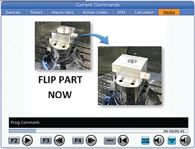

Your media appears in the Media tab under Current Commands. The media displays until the next M130 displays a different file, or M131 clears the media tab contents.
Media Display Example - Work Instruction during a Program
