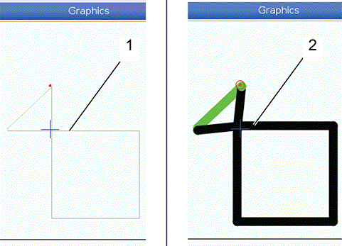

If this setting is ON, Graphics mode uses default tool width (a line) [1]. If this setting is OFF, Graphics mode uses the Tool Offset Diameter Geometry specified in the Tool Offsets table as the graphics tool width [2].
Graphics Display with Setting 253 On [1] and Off [2].
