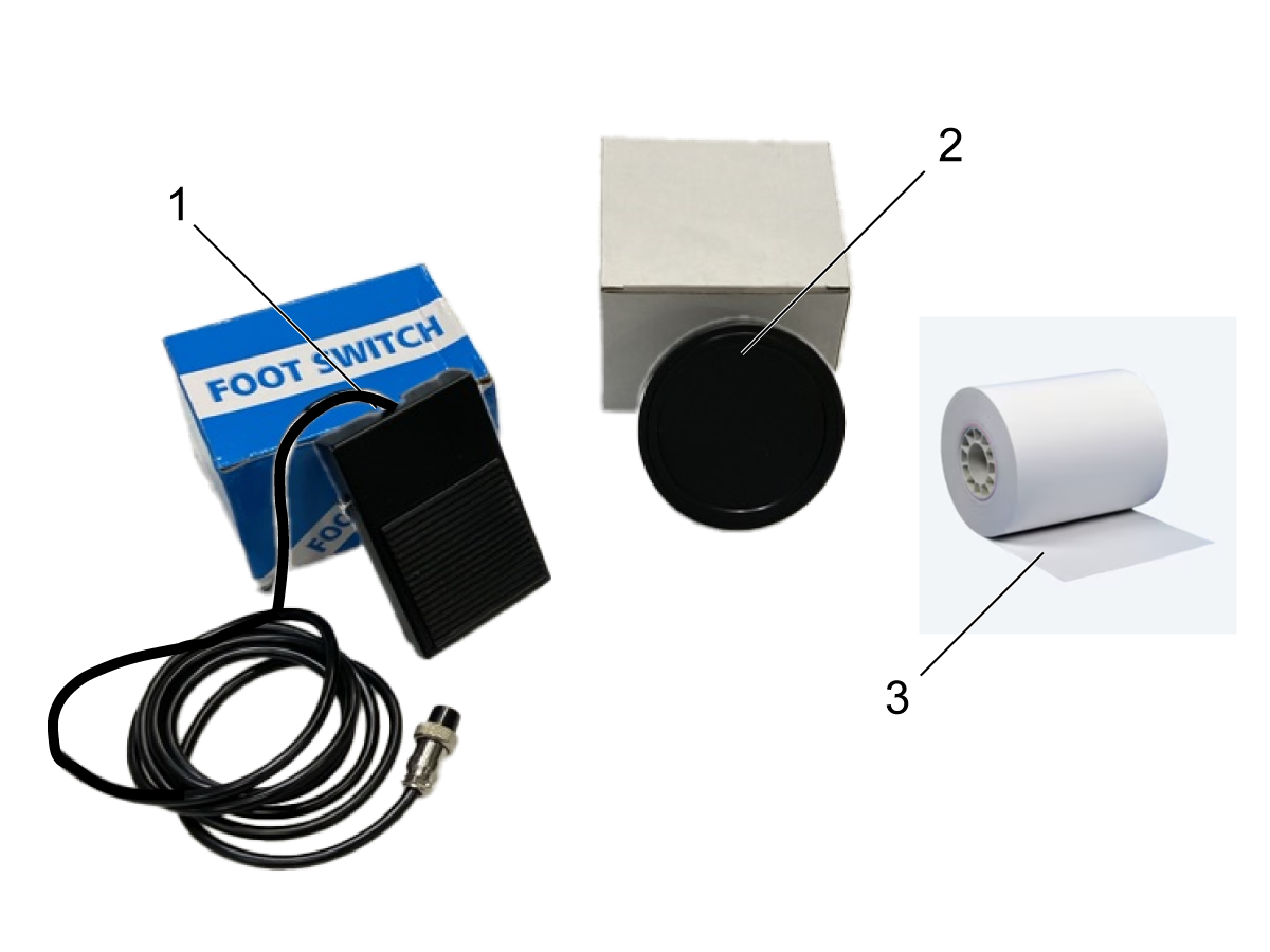

Included accessories:
    Foot Switch [1]
    F300 [210x210mm] F-Theta Lens [2]
    Thermal Receipt Paper Roll  [3]

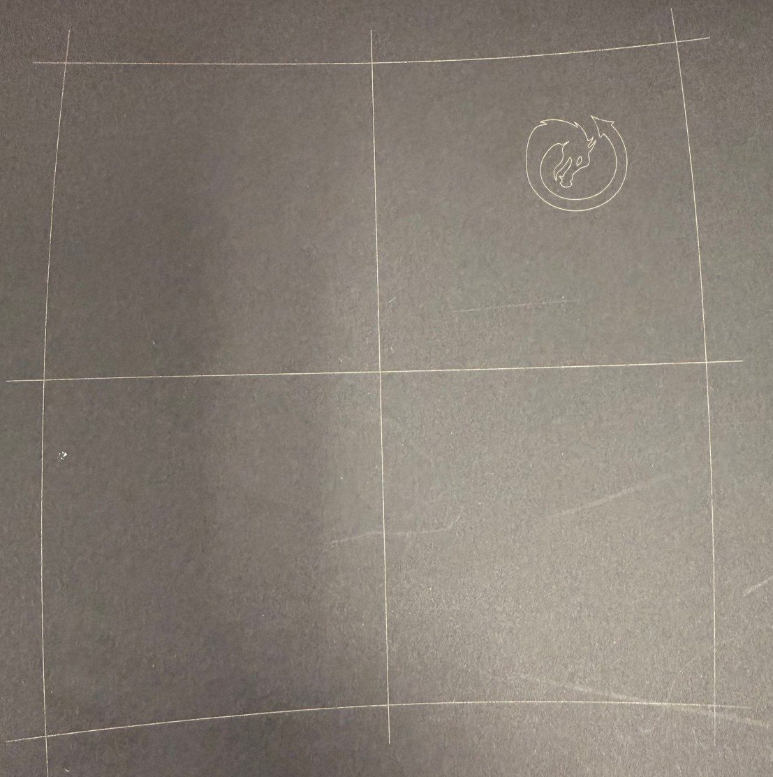

Galvo Lens Calibration
Calibrate the lens.
IMPORTANT: It is important to have the Galvo Lens calibrated to avoid skewed engravings and any bulging on the material. Remove lens caps before operating laser.
To calibrate the lens, refer to Galvo Lens Calibration.
You can also find relevant information in the Swapping Lenses section in the Operations Chapter found in the manual, see: 4 - HL - CO2 Series - Operation.
This image illustrates the expected reference markings on the black construction paper following execution of the Galvo lens calibration procedure.
