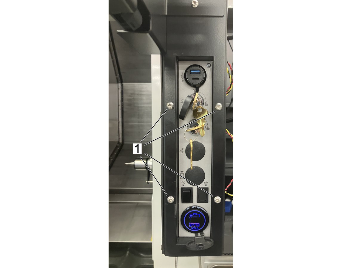

This option requires that the correct bulkhead be installed. Bulkhead [1] is the new required one, and Bulkhead [2] is the previous version. The previous version can be identified by the extra screw holes [3].

The longest Ethernet cable [1] needs to be run from the electrical cabinet to the pendant. This will require removing the sheet metal to route the cable, following the other cables going to the front pendant.
To replace the bulkhead, unscrew the back panel of the control pendant and then unplug all bulkhead connectors [1].
Once all the bulkhead connectors are unplugged, unscrew the previous bulkhead [1] and replace it with the one included in the kit.
With the new bulkhead installed, reinstall all the old bulkhead connectors except the top USB connector [1]. Then install the new USB bulkhead.
Use the included double-sided tape to attach the POE to USB-C adapter [1] to the cabinet. Plug the Ethernet cable that is routed from the electrical cabinet into the adapter. Plug the USB-C end of the adapter into the bulkhead.
