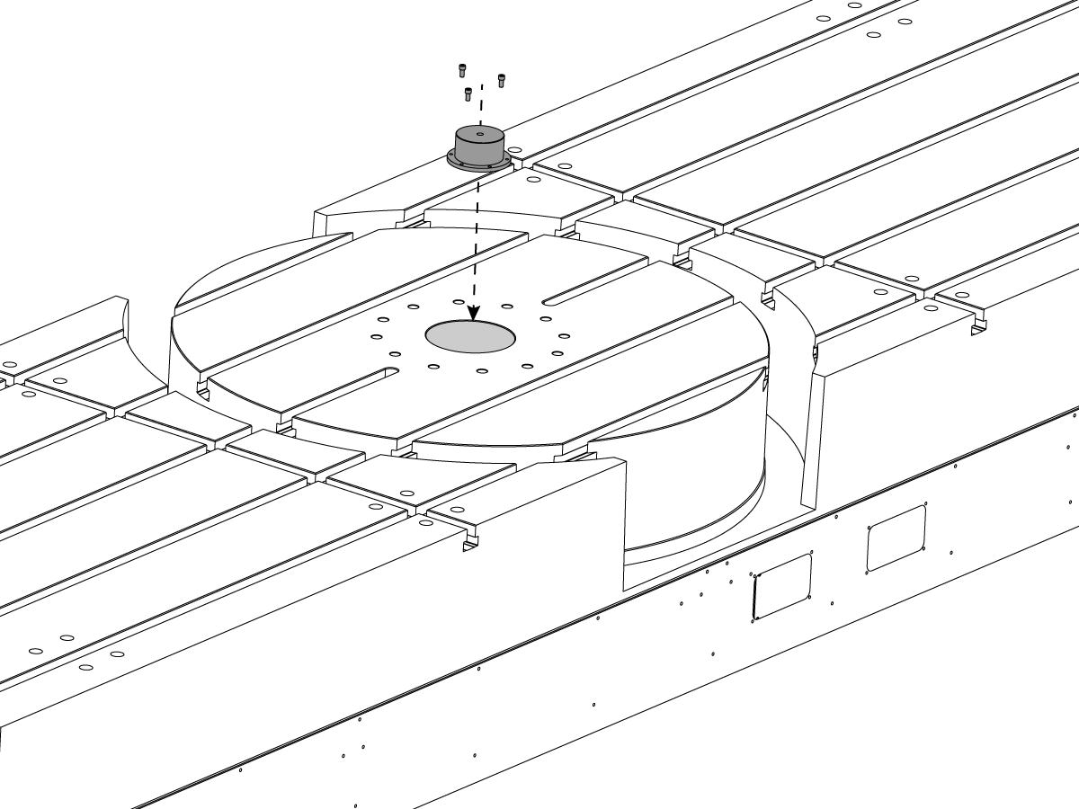

ENCODER REMOVAL

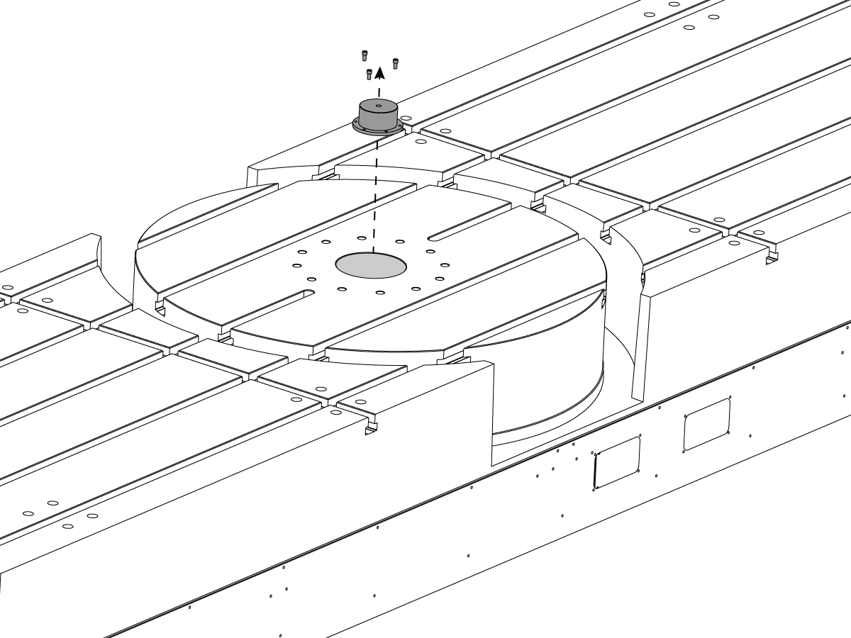

  • Remove the encoder cover plate [1].
  • Loosen the two set screws [2] in the encoder shaft plate [3].
  • Remove the six screw from encoder shaft plate.
  • Lift encoder shaft plate from the platter.
Important: Damage to the encoder will result if screw are not loosened.

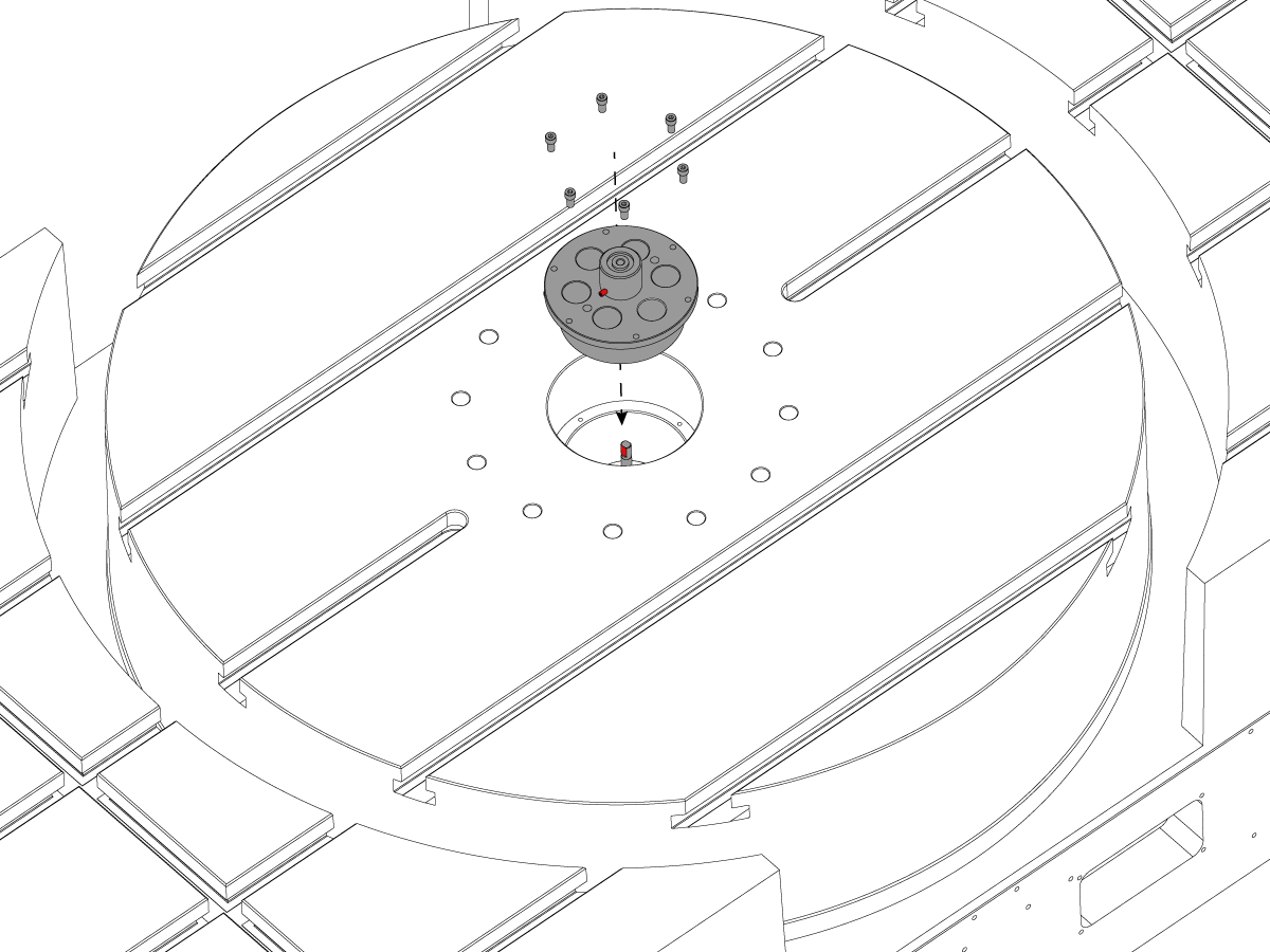

  • Remove the three screws on encoder coupling tube.
  • Remove the encoder coupling tube.
  • Remove the remaining three screws.

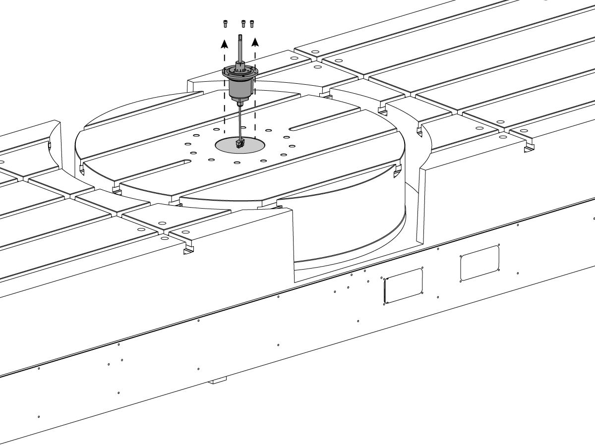

  • Carefully lift the encoder mount plate
  • Disconnect the encoder cable from the encoder feed back cable.
NOTE: Secure the encoder feed cable, to prevent cable from falling through the Encoder Mount Cup
  • Measure the height of the flex coupler to the face of the encoder mount plate [1] or height of the extension shaft to the face of the encoder mount plate [2].
  • Record the value , will be used during reassembly .
              [1]
   [2]
  • Loosen the lower set screw on the flex coupler to remove from encoder shaft.

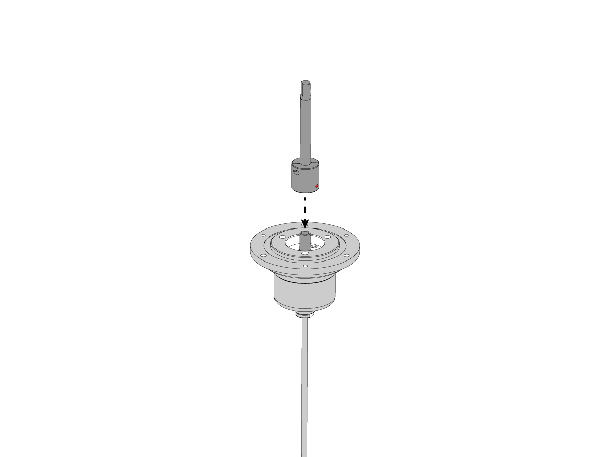

ASSEMBLE ENCODER
  • Install the new encoder onto the bottom of the new encoder mounting plate.
  • Install flex coupling to height recorded.
WARNING: Failure to install encoder shaft to correct height will result in damage to flex coupling and encoder.
  • Verify encoder coupler tube fit over the flex coupler free without binding.

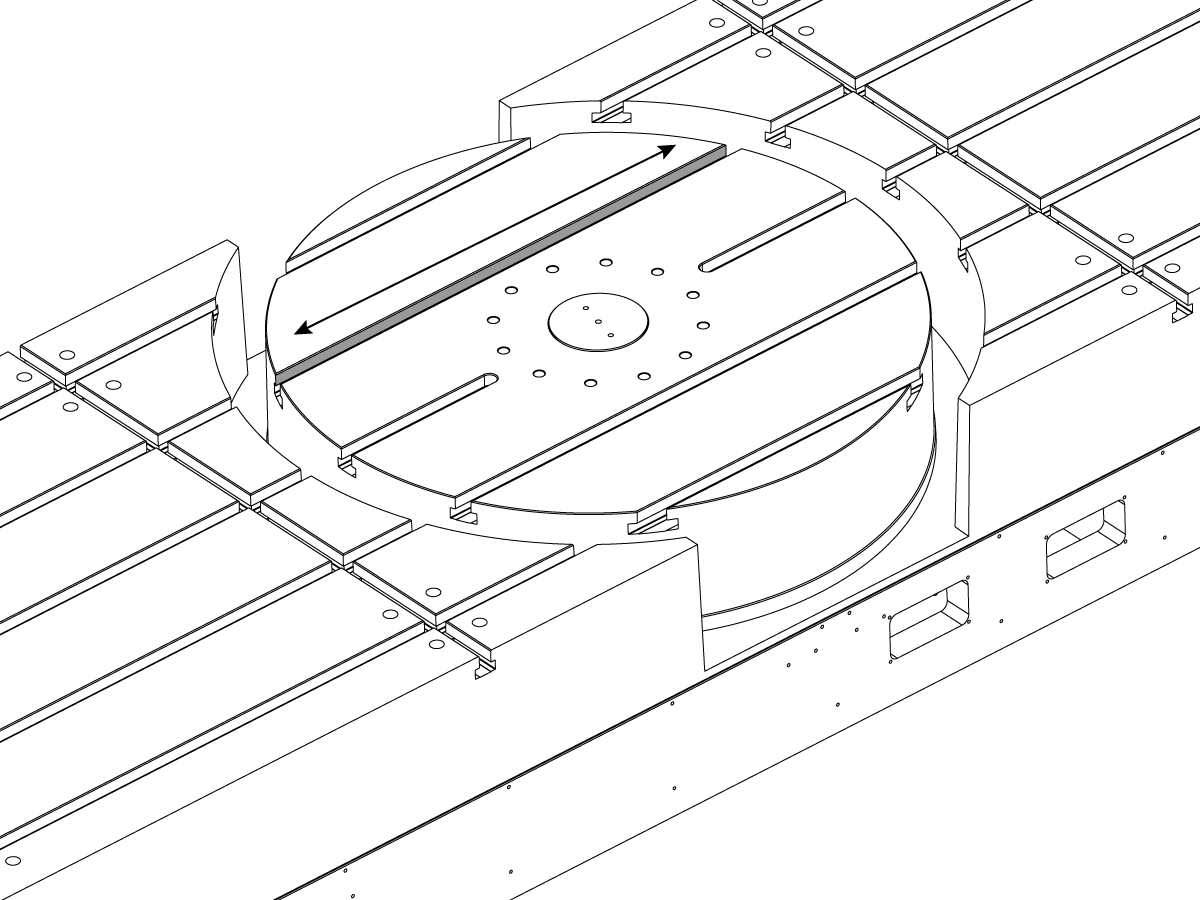

A-AXIS ALIGNMENT AND PARAMETER SETTINGS
  • In Service mode (Pos-Raw Dat screen), go to Parameter 212 (224 for EC-630/1600/2000/3000), enter “0” and press Write/Enter.
  • Zero the A-axis only by pressing the Zero Ret key, then the A key, then the Zero Singl Axis key.
  • Go to Service mode and type “GRID” followed by a space and then “A”.
  • Jog the A-axis to line up the T-slots (EC-1600/2000/3000, HS-3R/4R/6R/7R) with the X-axis to a value of .0005/10.00”.
  • Enter actual value from Pos-Raw Dat screen into Parameter 212 (224 for EC-630/1600/2000/3000).
