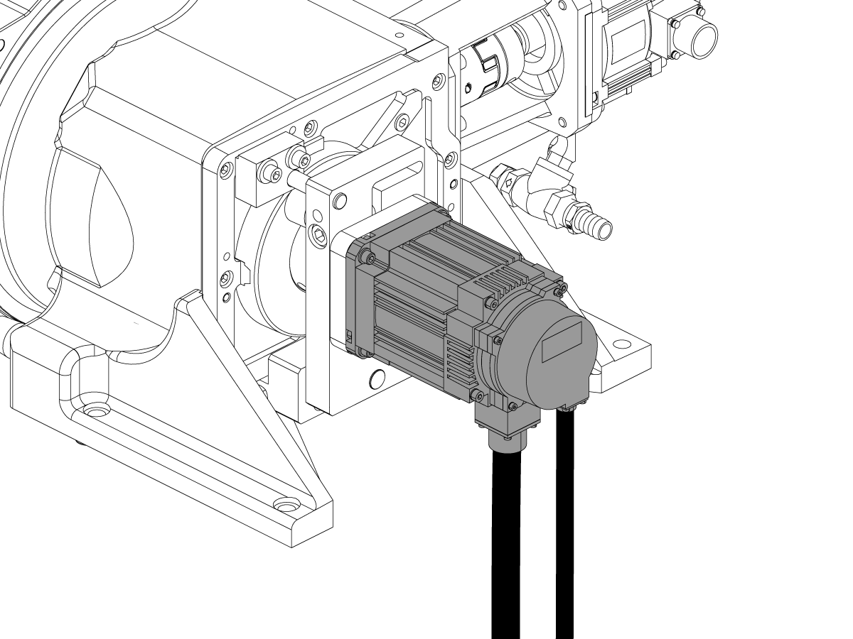

This procedure shows how to replace a the Live Tooling Motor on a BMT45 gearbox.
This Document Applies to the following Service Kits:
  • 93-4561 BMT45 LT Motor Kit
Required tools for live tooling turrets:
  • Service USB Key
  •  T-0147
Note : The motor provided is this service kit is for the spline driven live tooling shaft.
Replacement
Disconnect the motor power [4] and encoder [5] cables then remove and replace the live drive motor.
Note : Inspect the live drive splines for damage if motor removal is difficult.
Important : Do not preform tool changes without resetting output shaft alignment or the removal of all the live tool holders to avoid severe damage.
