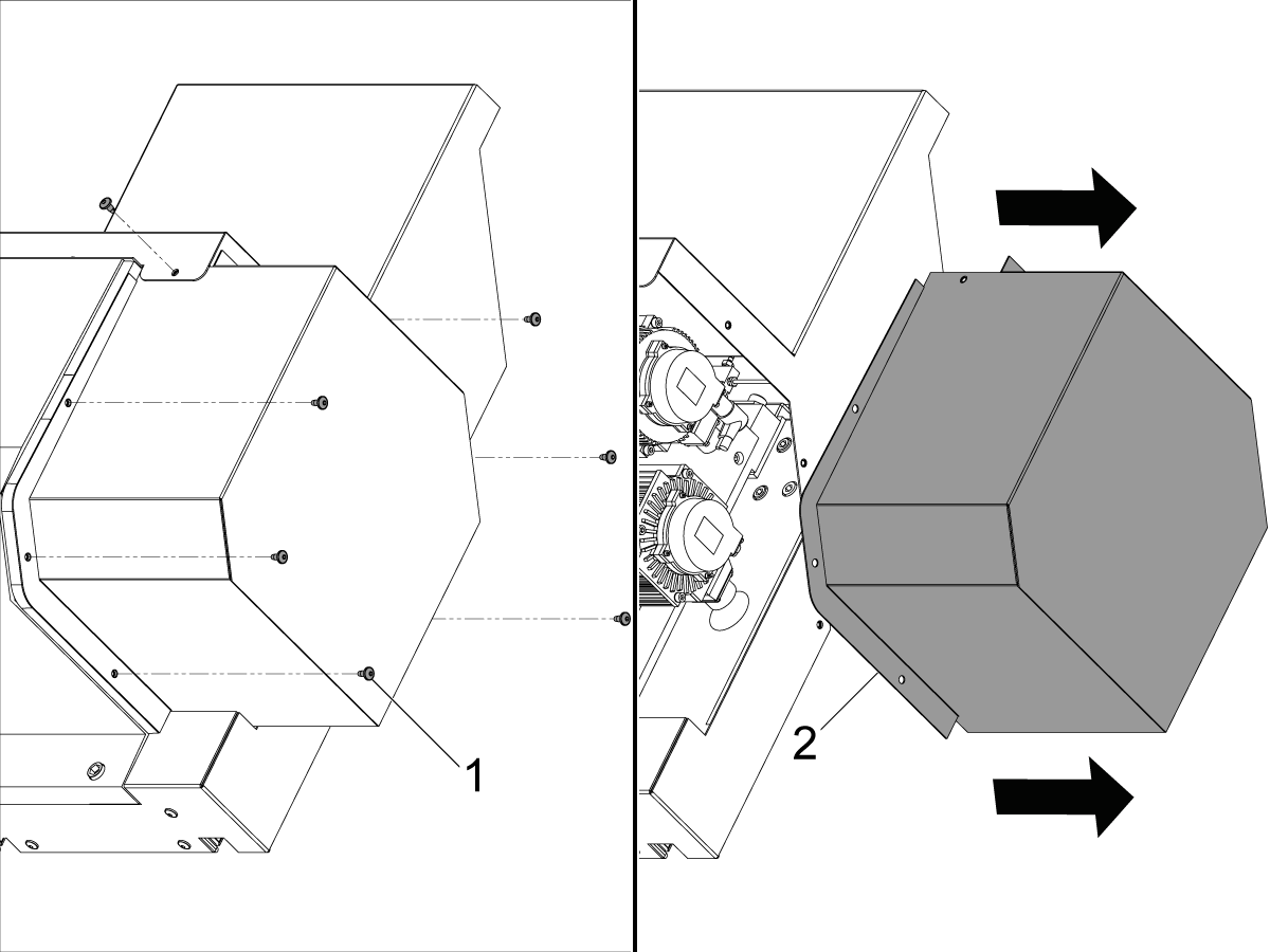

Remove the rear turret cover.
Important : Before the complete removal of the rear cover ensure that the internal cooling fan is disconnected.
Disconnect the motor power [4] and encoder [5] cables then remove and replace the live drive motor.
