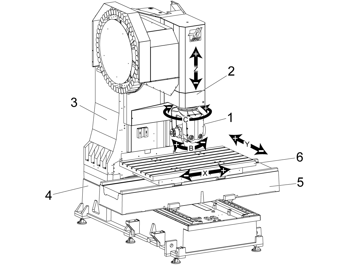

 Note: This procedure applies to the Double Yoke machine. Follow the H-5AX Single Yoke Spindle Head - Geometry Guide for the VR Single Yoke machines.
This procedure will go over how to adjust the following components on the VR-series machine:
  1. Haas 5-Axis Head
  2. Spindle Head
  3. Column
  4. Base
  5. Saddle
  6. Table
Note: As mentioned before this procedure can be used as an aid to the inspection report, but adjustments made without consultation from Haas Service will void warranty for the machine.

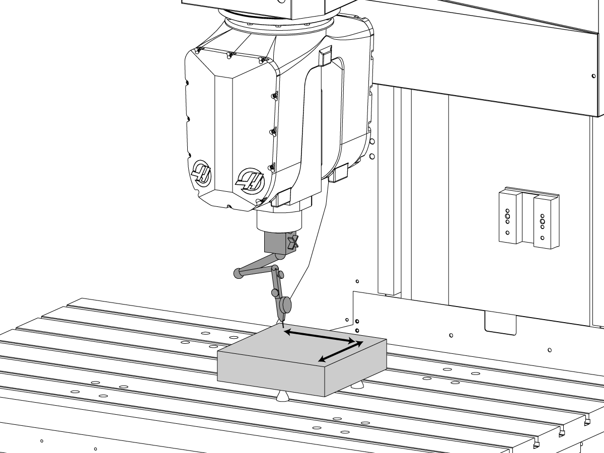

Flatness of Square Granite
Place three leveling jacks on the VR table then place a 12 inch (305mm) square granite on the leveling jacks.
Adjust the surface of the granite flat. This is NTE 0.0001"

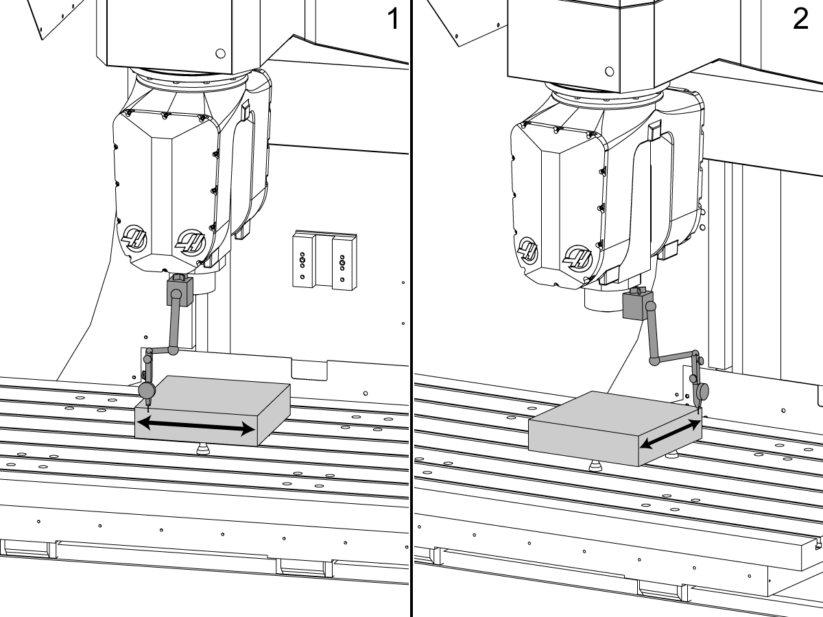

X-Axis to Y-Axis Perpendicularity
With the granite adjusted flat, place the indicator on the front face of the granite [1]. Zero the indicator and run it across the granite, adjust the granite so that both ends read zero.
Once the X-axis plane is zeroed. Place the indicator on one of the sides of the granite [2]. Parallel to the Y-axis plane. Zero the indicator on one end of the granite and run the indicator to the opposite end of the granite. Record the measurement.
This measurement is NTE 0.0005/10"
Note: The X-Axis and Y-Axis waycovers will need to be disconnected from the saddle to gain access to the bolts.
To adjust the Y-Axis perpendicular to X-Axis loosen the five bolts connecting the Y-Axis Ballnut to the Ballnut housing, and the ten bolts that connect the Ballnut housing to the saddle.
Loosen the hardware [1] on the front of the saddle that connects the casting [2] to the linear pads. Be sure to loosen all 4 pads.
NOTE: There is hardware [3] for each linear pad found under the table that needs to be loosen as well to make this adjustment. This hardware can be either SHCS or studs.
Once the bolts for all 4 linear pads are loosened, jog the saddle front to back a few times. Tap the saddle to make adjustments if needed.
Once the perpendicularity is within spec, tighten and torque all bolts back to specification using the HAAS TORQUE SPECIFICATION and re-check the X-Y perpendicularity.
WARNING: This step may be used as reference for the inspection report but do not make any adjustments before consulting with Haas Service. Adjustments made without consulting Haas Service will void warranty.

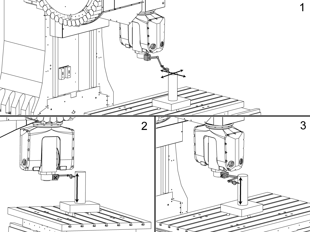

X-Z plane & Y-Z Plane Perpendicularity
Place a cylinder on the granite and place an indicator on the top face of the granite [1]. Adjust the cylinder flatness so that the indicator reads zero in X/Y motion by shimming under the cylinder.
Place the indicator on the back face of the cylinder [2], zero the indicator, and jog the Z-axis up and down. This measurement is NTE 0.0005/10".
Place the indicator on the side face of the cylinder [3], zero the indicator, and jog the Z-axis up and down. This measurement is NTE 0.0005/10".
IMPORTANT: This step is for reference only.  The column should not need to be adjusted, as the head geometry may influence this value. If any adjustments need to be made Haas service approval is  necessary. Adjustments made without consulting Haas Service will void warranty.
To adjust perpendicularity in either plane place shims on the highlighted portion of the riser block [1].
The shim amount should not exceed 0.008" thickness.

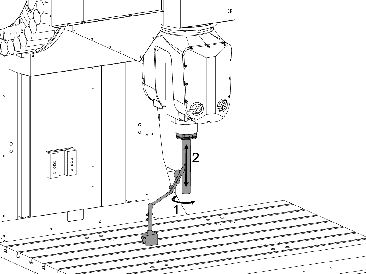

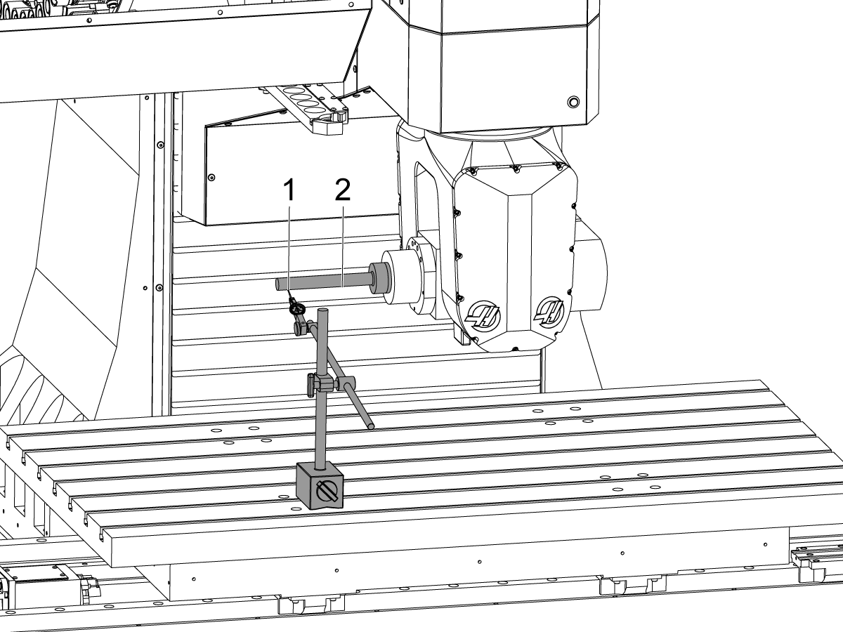

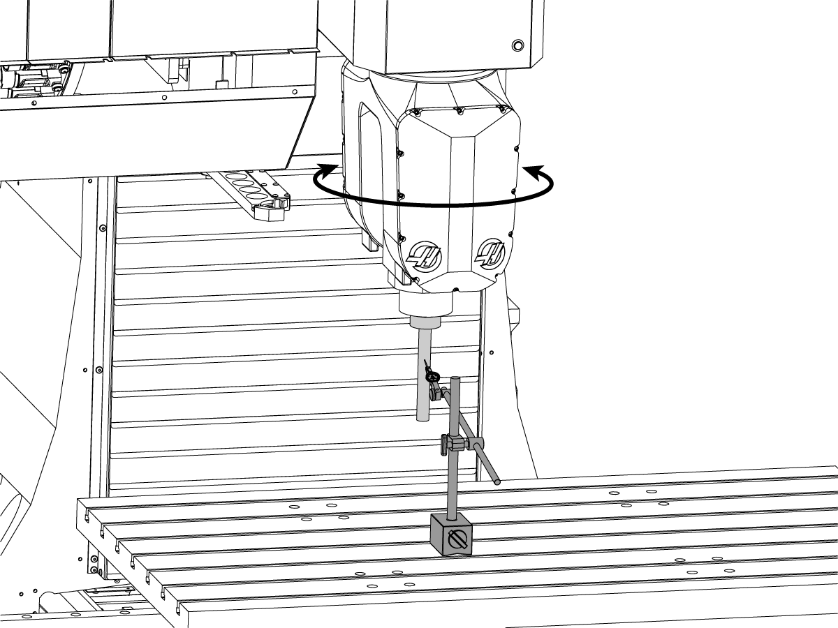

C-Axis Parallel to Z-Axis
Place an indicator on the B-Axis body and place the indicator on the face of the granite, set up the indicator so that it can sweep the granite with a 10" diameter.
Zero the indicator and rotate the C-Axis 360 degrees and record the measurement. This measurement is NTE 0.0008/10" diameter.
 Note: You will not be able to fully rotate 360 degrees in one direction as the head has +245 to -245 travel limits.

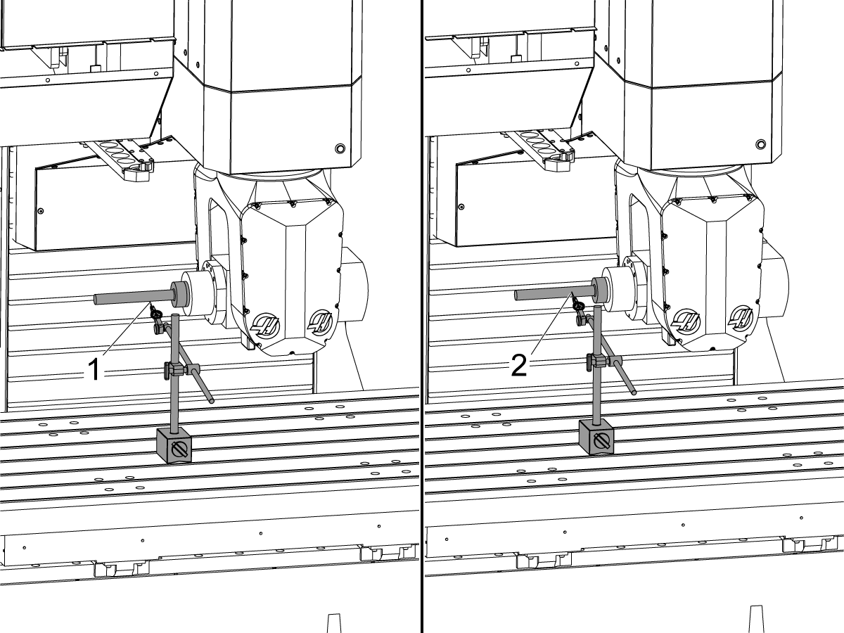

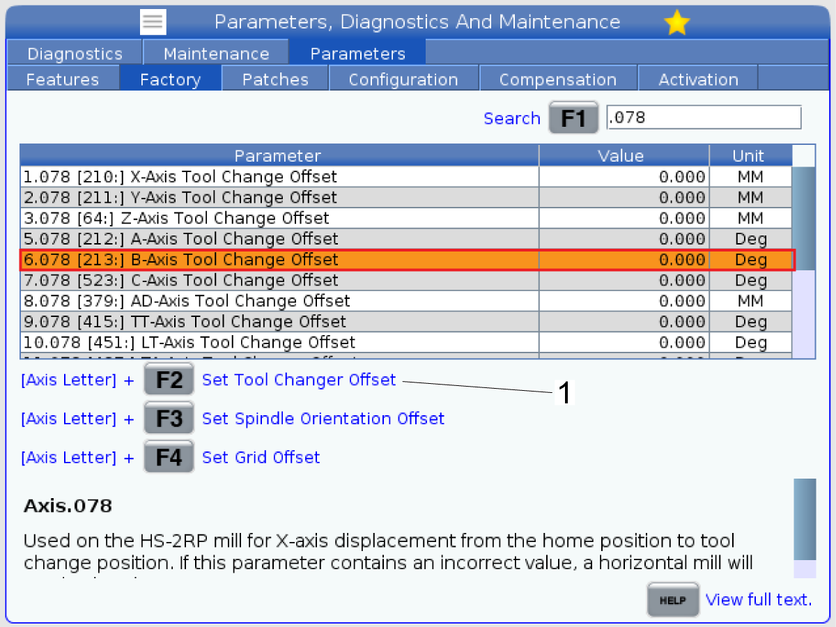

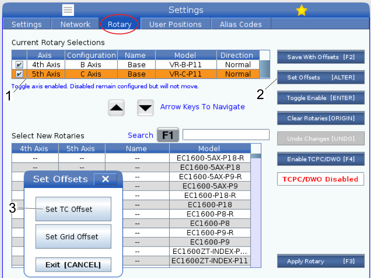

B-Axis Tool Change Offset

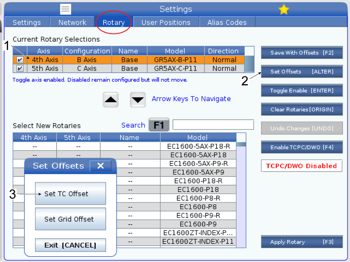

To adjust the B-Axis Tool Change Offset. Home the B & C-Axis and place the indicator on the side face of the test arbor.
Find the high spot on the test bar by jogging the Y-Axis. Once the indicator is on the high spot jog the indicator up and down the test bar and adjust the B-Axis so that the error on the indicator is no more than 0.0001".
Use the following instructions to change the B-Axis Tool Change Offset if a service key is not available.
Press [SETTING] and navigate to the rotary tab. Highlight the 4th axis selection [1] and press [ALTER] [2] to set the B-Axis Tool Change Offset [3].
After adjusting the B-Axis Tool Change Offset. Redo the inclination test, sweeping from position [1] to [2]. If the inclination is out of tolerance after adjusting the offset, redo the adjustment portion.
If a service key is available press [DIAGNOSTIC] and navigate to the parameters tab and to the factory tab. Find Parameter 6.078 B-AXIS TOOL CHANGE OFFSET to set the Tool Change Offset by pressing the [B] + [F2] to set the offset to the current position.
After adjusting the Tool Change Offset. Redo the inclination test, sweeping from position [1] to [2]. If the inclination is out of tolerance after adjusting the offset, redo the adjustment portion.

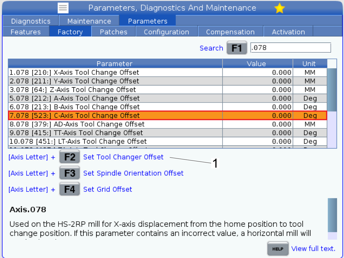

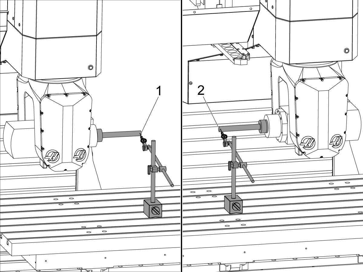

C-Axis Tool Change Offset
Home the B and C-Axis.
In MDI command the B-Axis to -90°.
Place an indicator on the front face of the test bar at the end of the bar [1] on the high spot. Zero the indicator at this location.
Jog the Z-Axis up so the test bar clears the table and command B = +90°. Jog the table in the Z and X direction to move the indicator to position [2] on the front face of the test bar at the end of the bar on the high spot. Adjust the C-Axis so that the error on the indicator is the same between positions [1] and [2]. This should not exceed 0.0005".
Once the end of the test bar reads the same error at both B = -90 and B = +90 degrees set the C-Axis Tool Change Offset. See steps below.
 Note: Do not move the Y-Axis during this step.
Use the following instructions to change the C-Axis Tool Change Offset if a service key is not available.
Press [SETTING] and navigate to the rotary tab. Highlight the 5th axis selection [1] and press [ALTER] to set the C-Axis Tool Change Offset [3].
If a service key is available press [DIAGNOSTIC] and navigate to the parameters tab and to the factory tab. Find Parameter 7.078 C-AXIS TOOL CHANGE OFFSET to set the tool change offset by pressing [C] + [F2] to set the offset to the current position.

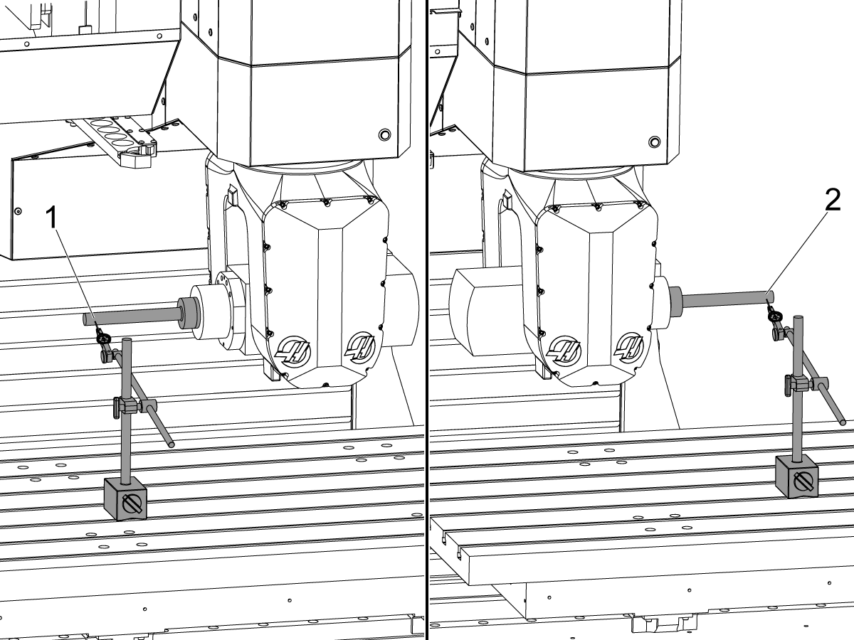

B-Axis to C-Axis Perpendicularity
Once the face of the test bar reads zero at B =-90° and B = +90°, in MDI command the B-Axis to 0°.
Jog the table to move the indicator to position [1] on the test bar. Make sure to jog in the Z and X direction to find the "high" value in the B = 0 position. Record the value. DO NOT SET THE INDICATOR BACK TO ZERO.

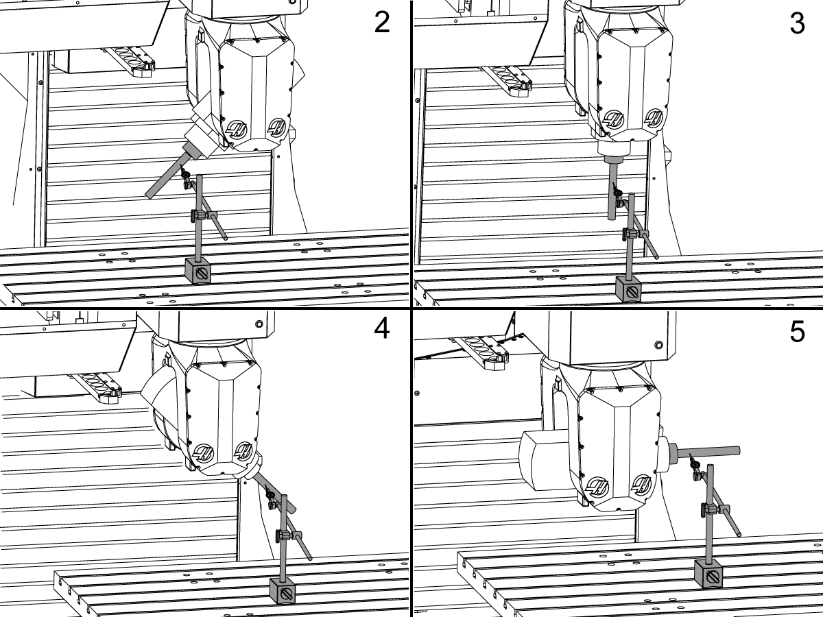

B-Axis Sweep
In MDI command the B-Axis to +90°.
Place the indicator on the bottom face [1] of the test bar and sweep the whole travel. Make sure this is straight, if not, adjust the B-Axis until it is.
Then place the indicator on the front face and zero the indicator 4 inches away from the face of the spindle [2]. It is recommended to mark a point on the test bar to indicate the spot to take measurements on the next portion of the test.
On the operators page, set the Y, Z, and B-Axis to zero.
 Note: This test will move the B-Axis in 45 degree increments and creates a plane that will be evaluated.
The starting position will be at B = +90 shown in the previous step, this will always be our zero.
Jog the B-Axis to B = +45.
Jog the table to move the indicator to the position that was marked on the test bar. Make sure to jog in the Z and X direction to find the "high" value in the B = +45 position. Record the value.
 Note: It is recommended to use a dual dial test indicator.
Jog the B-Axis to B = 0, B = -45, and B = -90 position, all while jogging the table to move the indicator to the marked position on the test bar in each of the B-Axis movements and record the values. Find the "high" spot in each of these positions to take the measurement.
 Note: It is recommended to not move the Y-Axis during this test, but if it is moved return it to the operators Y-Axis zero position.
In MDI command the C-Axis to +180°.
Jog the B-Axis to B = -90.
Then place the indicator on the front face and zero the indicator 4 inches away from the face of the spindle. It is recommended to mark a point on the test bar to indicate the spot to take measurements on the next portion of the test.
Redo the sweep steps mentioned in the previous step and record the values. The difference between the measurements in run 1 and run 2 at each B-Axis position divided by 2, is NTE 0.004" (Run 1 is at C = 0, Run 2 is at C = 180; use latest inspection report to help calculate).

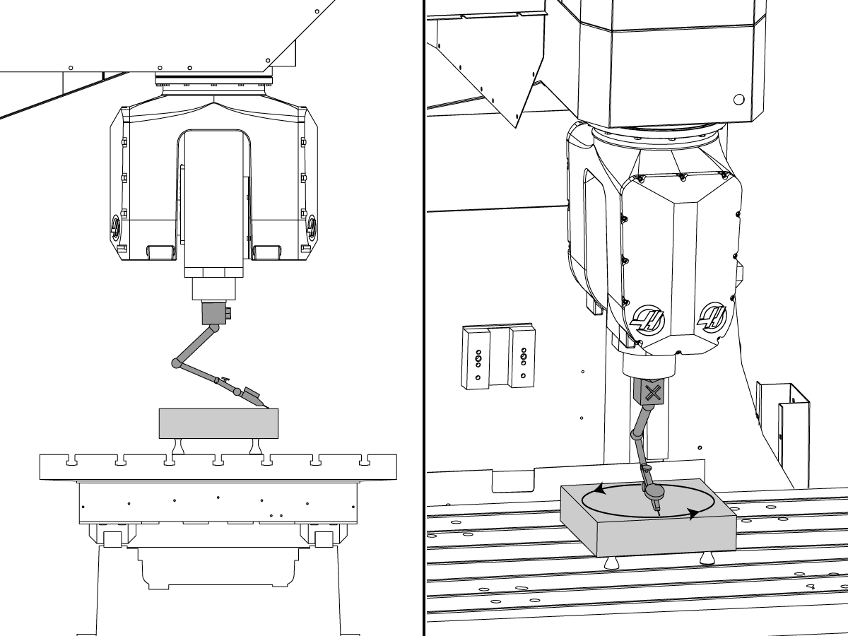

Inspection Report

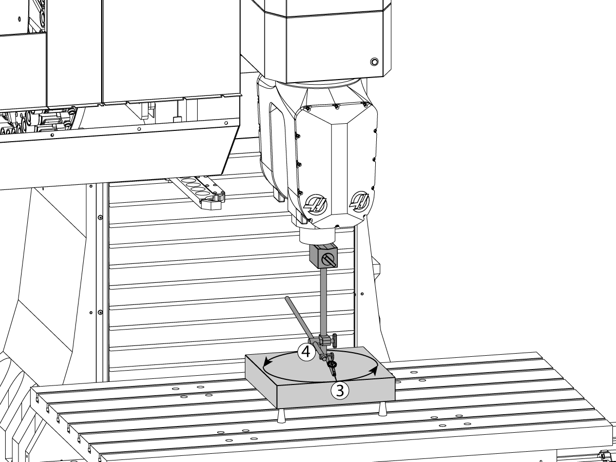

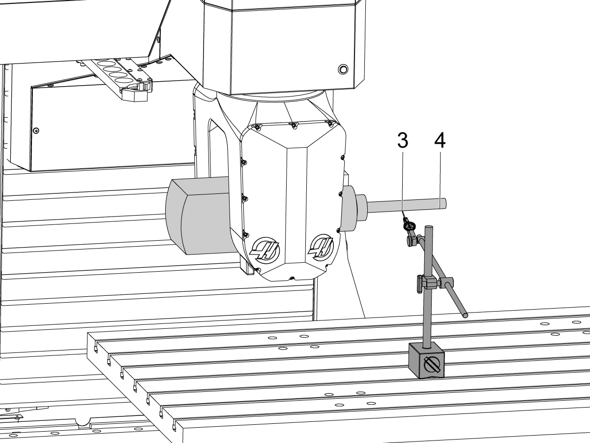

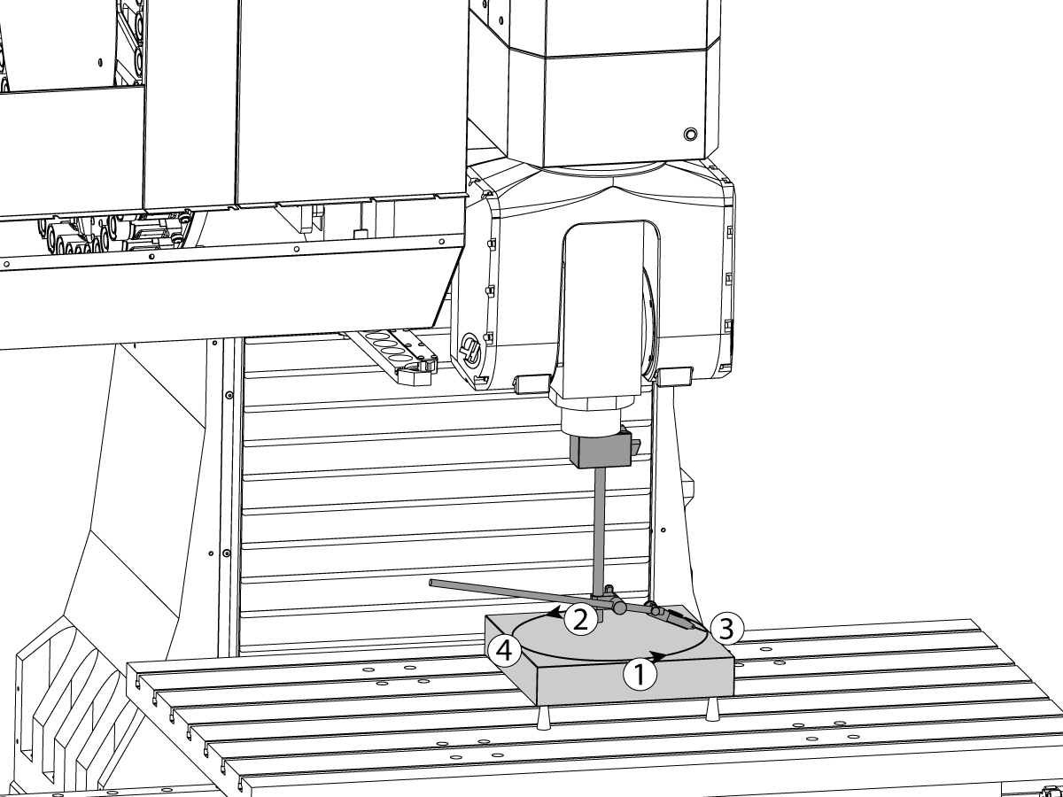

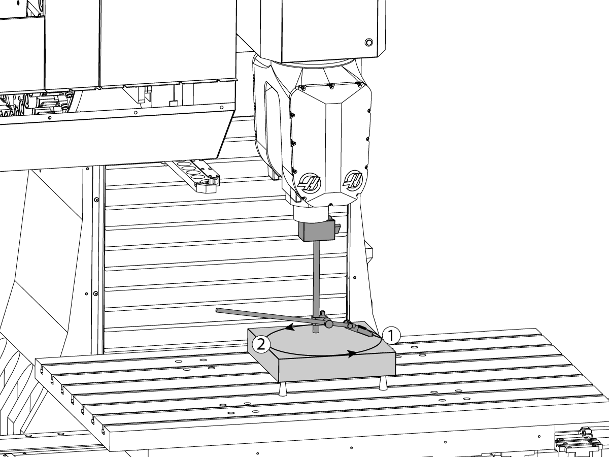

Spindle Centerline Parallel to C-Axis
Home the B and C-Axis, mount the indicator on the spindle nose and set the indicator to sweep a 10" diameter circle. Set the indicator to zero at position [1] and sweep to position [2]. This is NTE 0.0005"
Record the measurement and fix this by adjusting the B-Axis Tool Change Offset. See the B-Axis Tool Change Offset steps.
Note: The B-Axis Tool Change Offset must be set before moving on to sweeping positions [3] and [4].
Set the indicator to zero at position [3] and sweep a 10" diameter circle to position [4] and record the measurement, this is NTE 0.002".
Repeat the same steps above with the C-Axis at C = +90.
Set the indicator to zero at position [3]. Sweep to position [4] and record the measurement.
 Note: This check is to make sure the C-Axis is parallel to Z-Axis. You should see the same error when C = 0 and when C = +90. Any additional error is from the C-Axis parallel to Z-Axis step.

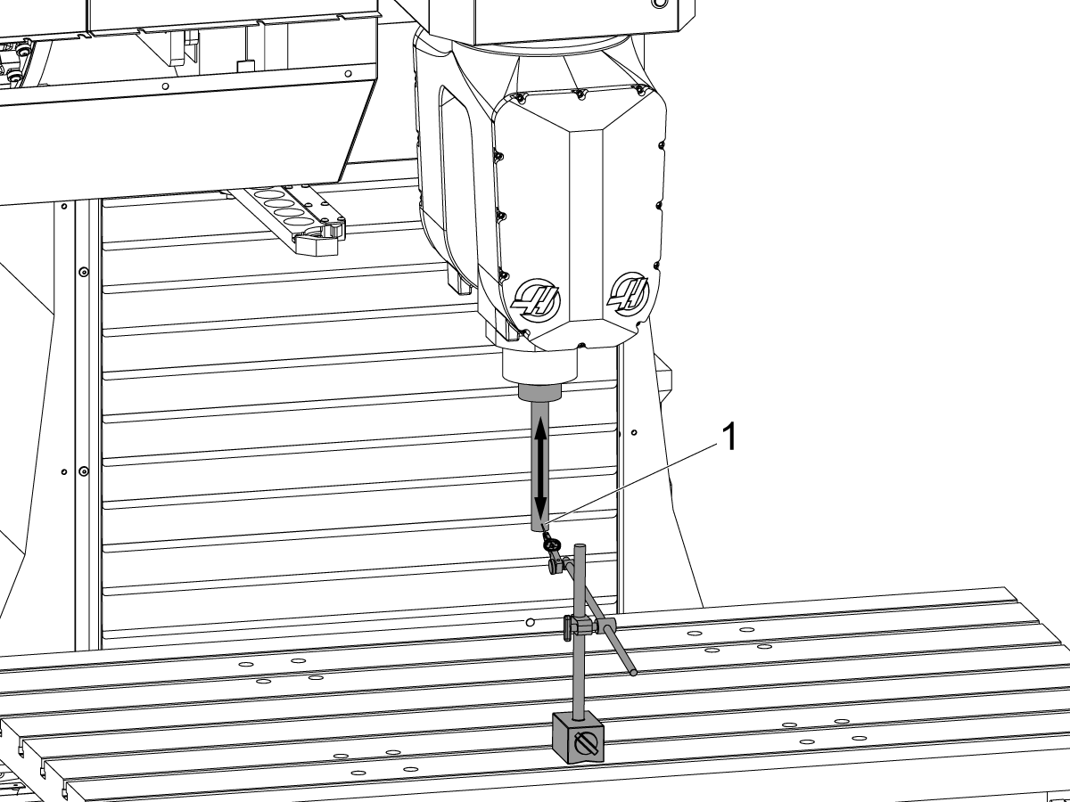

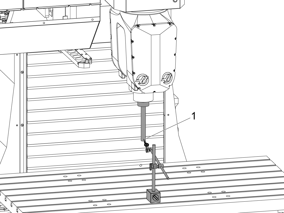

C-Axis Runout
Place an indicator on the front of the test bar 4 inches away from the spindle face. Find the high spot on the test bar by jogging the indicator along the X-Axis.
 Note: Hold the test bar when jogging the C-Axis.
Zero the indicator on the high spot and rotate the C- Axis +180/-180 degree's. Record the error at the following positions: C = +90, C = +180/-180, C = -90.
The error between C = 0 and C = +180/-180 is NTE 0.005" TIR.
The error between C = -90 and C = +90 is NTE 0.005" TIR.
Make a note of the C-Axis positions where the runout was the highest as this will be needed to make the adjustment.
Spindle Centerline and B-axis Intersection
Rotate the B-Axis 180 degrees to B = -90 and jog the table to set the indicator on the bottom side of the test bar.
It is recommended to not move the Y-Axis and only the X and Z. Jog the Z down to the zero position on the operators page. Sweep the bottom length of the test bar to make sure the error reads the same across the test bar. If it does not, adjust the B-Axis until it does. DO NOT MOVE THE Z-AXIS while making the adjustments, only the B-Axis. Divide the error by two. This is NTE 0.002".
If error exceeds tolerance contact Haas Service.
