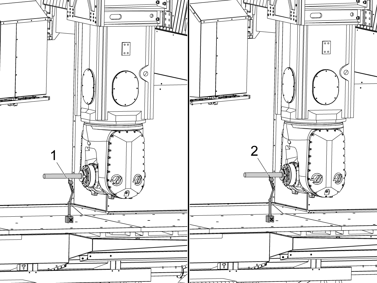

B-Axis to C-Axis Perpendicularity
Home the B and C-Axis.
In MDI command the B-Axis to -90°.
Place an indicator on the front face of the test bar at the end of the bar [1] on the high spot. Zero the indicator at this location.
Jog the Z-Axis up so the test bar clears the table and command B = +90°. Jog in the Z and X directions to move the indicator to position [2] on the front face of the test bar at the end of the bar on the high spot. Adjust the C-Axis so that the error on the indicator is the same between positions [1] and [2]. This should not exceed 0.0005".
 Note: Do not move the Y-Axis during this step.
Once the face of the test bar reads zero at B =-90° and B = +90°, in MDI command the B-Axis to 0°.
Jog the table to move the indicator to position [1] on the test bar. Make sure to jog in the Z and X direction to find the "high" value in the B = 0 position. Record the value. DO NOT SET THE INDICATOR BACK TO ZERO.
Spindle Centerline to B-Axis Perpendicularity
Jog the table to move the indicator to position [1] on the test bar. Make sure to jog in the Z and X direction to find the "high" value in the B = 0 position.  This value should match the one found in the B-Axis to C-Axis Perpendicularity section.
Zero the indicator at position [1]. Jog in the Z direction up the test bar. Record the error seen.
B-Axis Sweep
In MDI command the B-Axis to +90°.
Place the indicator on the bottom face [1] of the test bar and sweep the whole travel. Make sure this is straight, if not, adjust the B-Axis until it is.
Then place the indicator on the front face and zero the indicator 4 inches away from the face of the spindle [2]. It is recommended to mark a point on the test bar to indicate the spot to take measurements on the next portion of the test.
On the operators page, set the Y, Z, and B-Axis to zero.
 Note: This test will move the B-Axis in 45 degree increments and creates a plane that will be evaluated.
The starting position will be at B = +90 shown in the previous step, this will always be our zero.

Home the B & C-Axis and place the indicator on the side face of the test arbor.
Find the high spot [1] on the test bar by jogging the Y-Axis. Once the indicator is on the high spot jog the indicator up and down [2] the test bar and adjust the B-Axis so that the error on the indicator is no more than 0.0001".
Place an indicator on the front of the test bar 4 inches away from the spindle face. Find the high spot on the test bar by jogging the indicator along the X-Axis.
 Note: Hold the test bar when jogging the C-Axis.
Zero the indicator on the high spot and rotate the C- Axis +180/-180 degree's. Record the error at the following positions: C = +90, C = +180/-180, C = -90.
The error between C = 0 and C = +180/-180 is NTE 0.0015" TIR.
The error between C = -90 and C = +90 is NTE 0.003" TIR.
 Note: You will not be able to fully rotate 360 degrees in one direction as the head has +245 to -245 travel limits.
Make a note of the C-Axis positions where the runout was the highest as this will be needed to make the adjustment.
Spindle Centerline and B-axis Intersection
Jog the Z-Axis up so the test bar clears the table and command B = +90°. Jog in the Z and X directions to move the indicator to position [2] on the front face of the test bar at the end of the bar on the high spot. Adjust the C-Axis so that the error on the indicator is the same between positions [1] and [2]. This is NTE 0.0005".
 Note: It is recommended to use a dual dial test indicator.
Rotate the B-Axis 180 degrees to B = -90 and jog the table to set the indicator on the bottom side of the test bar.
It is recommended to not move the Y-Axis and only the X and Z. Jog the Z down to the zero position on the operators page. Sweep the bottom length of the test bar to make sure the error reads the same across the test bar. If it does not, adjust the B-Axis until it does. DO NOT MOVE THE Z-AXIS while making the adjustments, only the B-Axis. Divide the error by two. This is NTE 0.002".
If error exceeds tolerance contact Haas Service.
