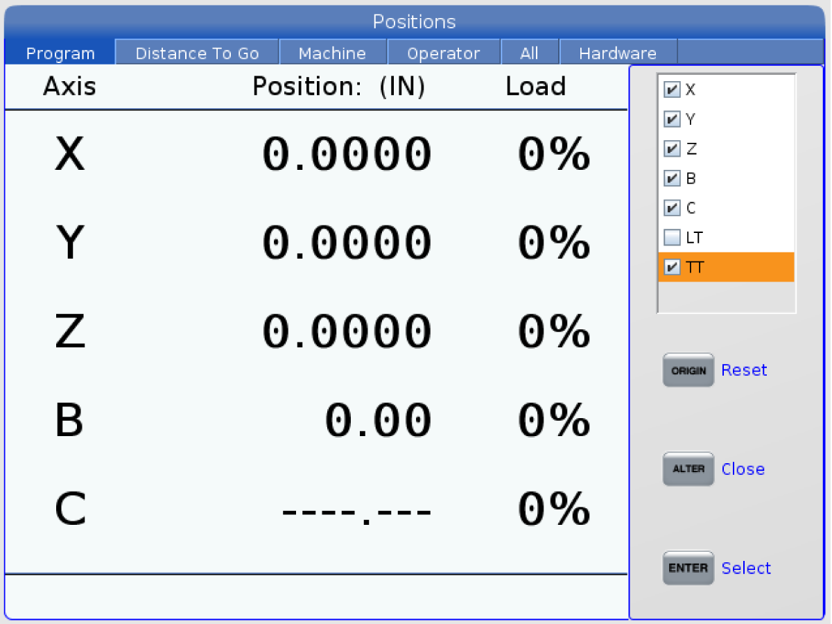

Make the TT-Axis visible on the display page by pressing [ALTER] then select the TT axis and press [ENTER].

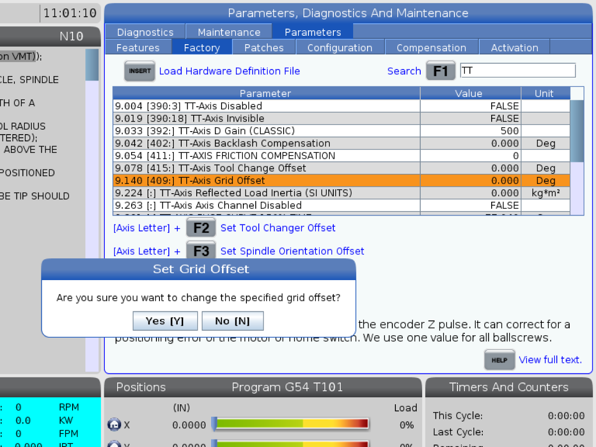

Set the Grid Offset:
  • Remove any tooling that may be in the way and zero return the TT-Axis by pressing [TT], [ZERO RETURN], and [SINGLE].
  • Ignore any alarms.
  • Press [E-Stop].
  • Navigate to the DIAGNOSTICS>FACTORY tab.
  • Type [TT] and press [F4] and then [Y] for Yes.
  • A value for parameter 9.140 should populate.
  • Press [ZERO RETURN] and [ALL].

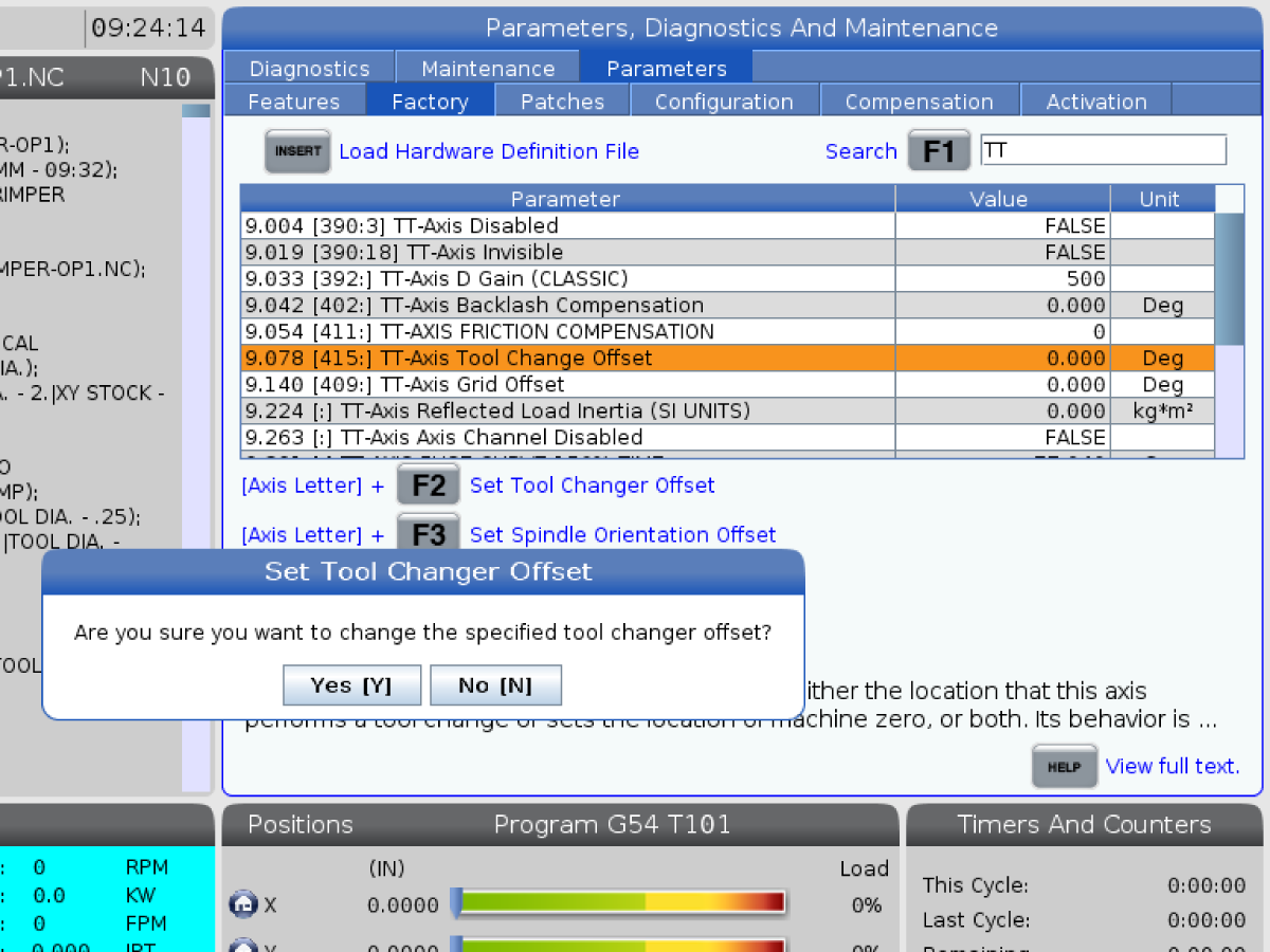

Set the Tool Change Offset:
  • In MDI mode command an M43 to unclamp the turret. Handle jog the TT-Axis until pocket 1 is in position, visually align the coolant nozzle. In MDI command a M44 to clamp the turret.
  • Press [E-Stop] and verify the turret is fully seated.
  • Type [TT] and press [F2] and then [Y] for Yes.
  • Zero Return the TT-Axis.

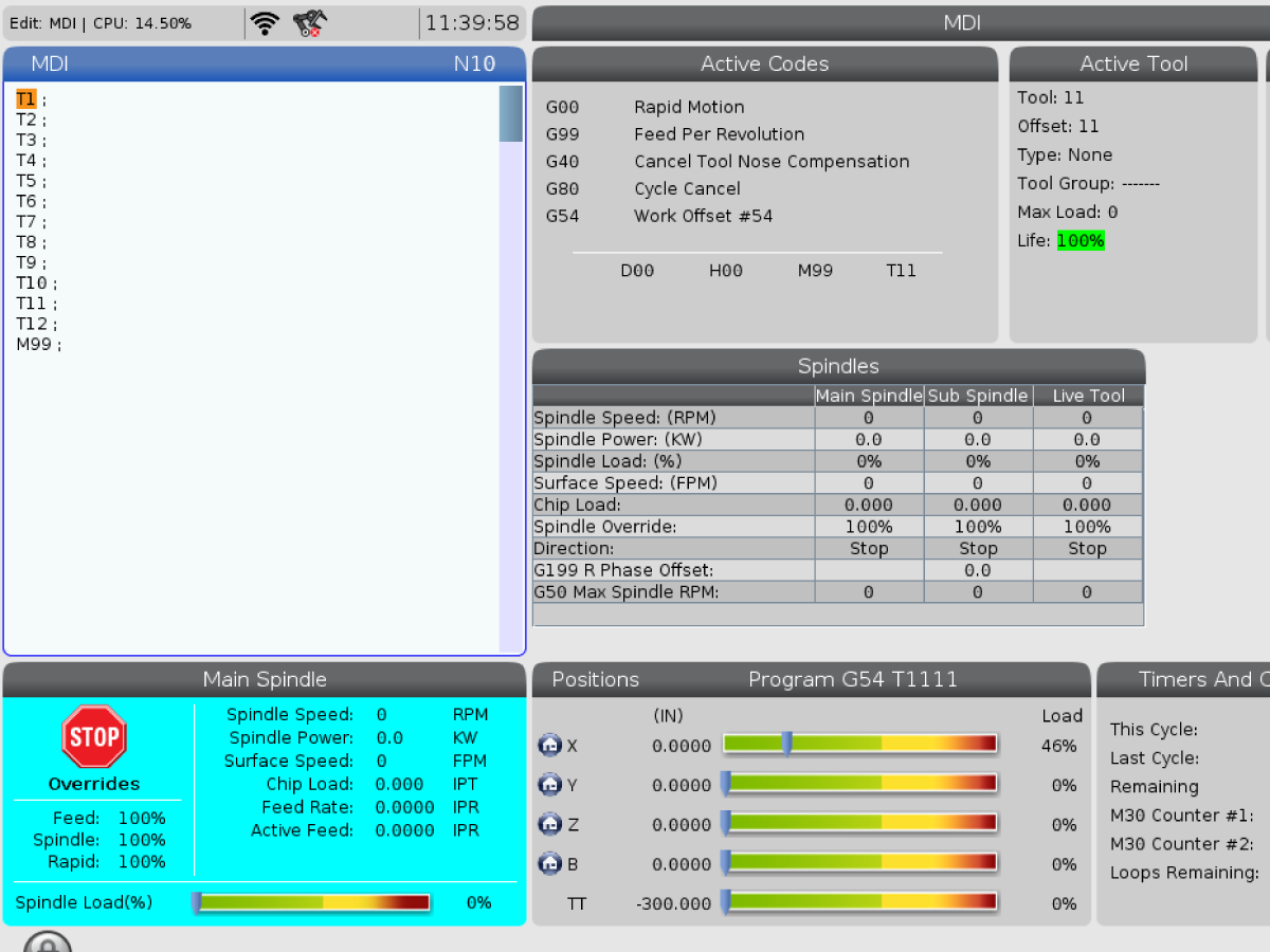

Verification
Operate this code in MDI mode:
T1;
T2;
T3;
T4;
T5;
T6;
T7;
T8;
T9;
T10;
T11;
T12;
M99;
 Important: Once clamped at each tool #, verify that the load is always below 5%.
Run the program for approximately 1 minute. Throughout the execution of the program, verify proper clamping / unclamping of the turret, and tool # position as commanded by the program.
Make the axis invisible on the display page by pressing [ALTER] then select the TT axis and press [ENTER].
