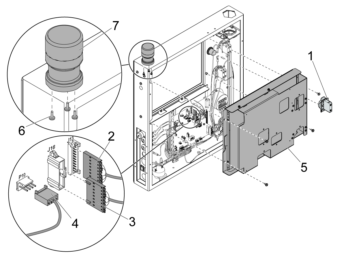

This procedure tells you how to replace an LED beacon light on a control pendant.
Remove the control pendant back panel. Disconnect the P10 cable [4] from the control pendant SKBIF.
Disconnect the J13 cable [2] and the J16 cable [3]. Remove the "Power Off" contactor [1]. Remove the LCD monitor assembly [5].
Remove the (3) LED beacon light screws [6] and the LED beacon light [7]. Replace the LED beacon light [7]. Install the components in the opposite order they were removed.
