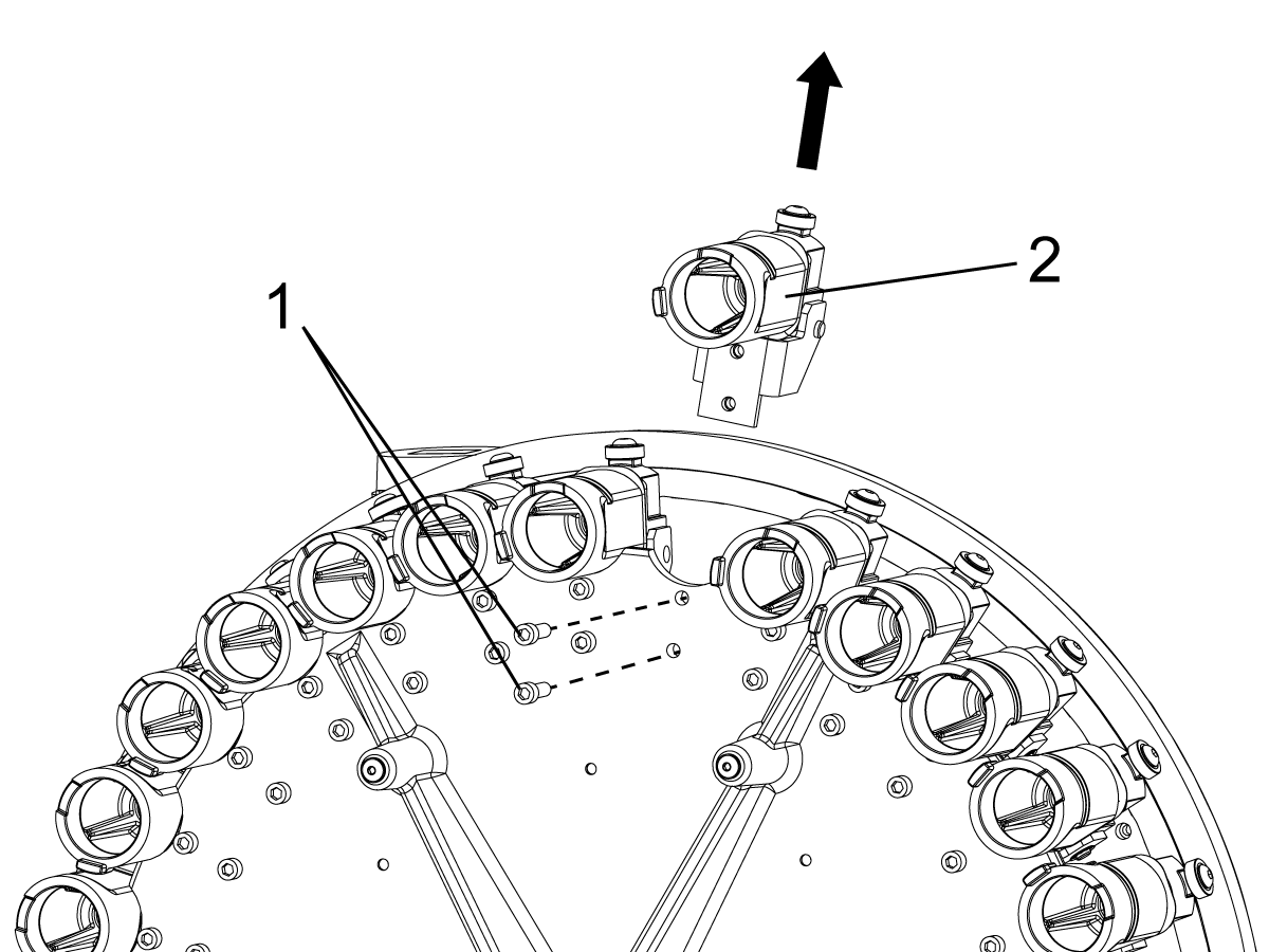

This procedures tells you how to replace the tool pocket on the SMTC-30T/50T.
Replacement
Remove the number plate from the carousel.
Remove the (2) 5/16-18 bolts [1] from the carousel for the damaged pocket.
Slide the pocket assembly [2] out from under the carousel plate.
Install the replacement pocket. Torque the (2) 5/16-18 bolts [1] to 25 ft lbs. Install the number ring in the correct orientation.
