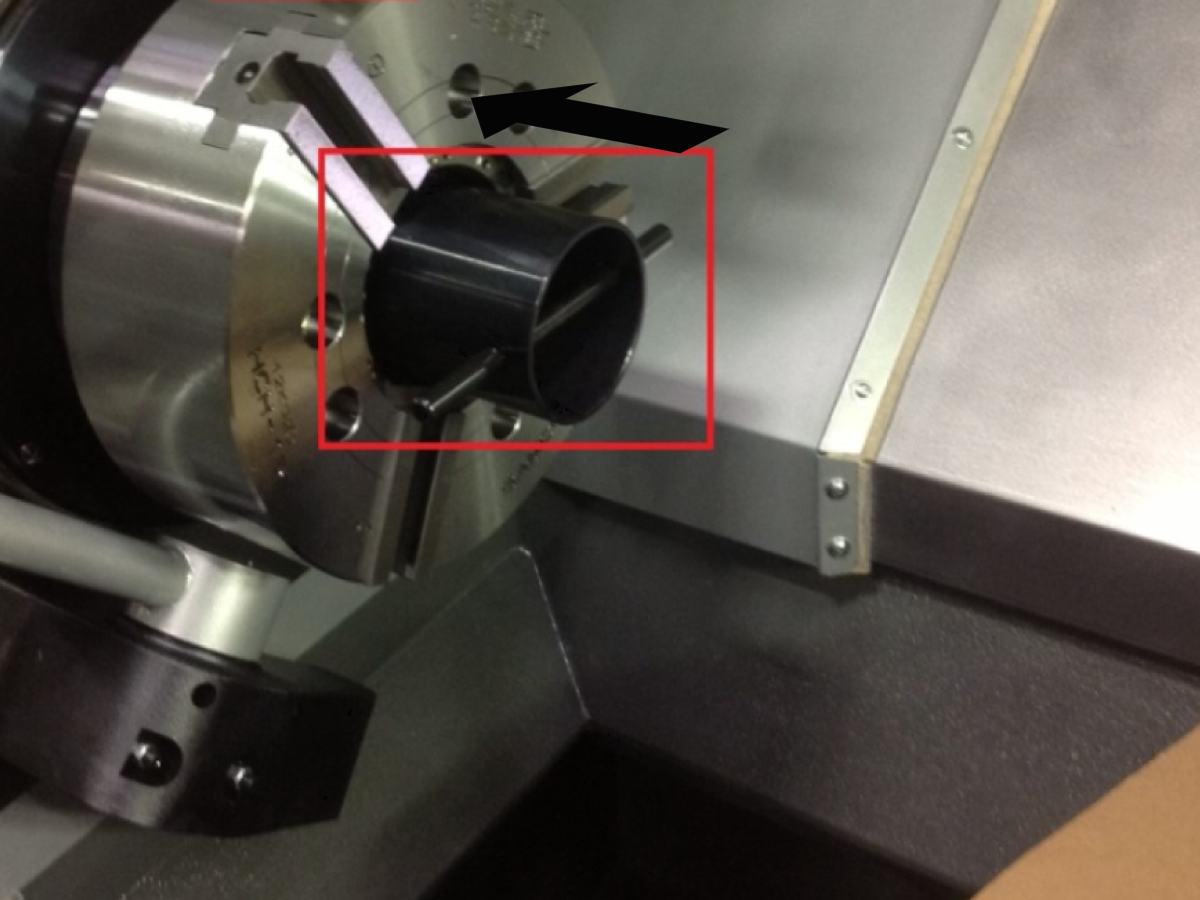

Hydraulic Chuck Removal
Push [POWER ON].
You may have to zero return machine before unclamping the chuck.
Unclamp chuck push [E-STOP] when jaws are about half way open.
The travel should be between .180" to .200"
Note: We do this so the chuck is in the correct position to remove drawnut from the drawbar.
Remove 2 of the 3 jaws on the chuck [1].
Note: Leave one jaw on so there is leverage to loosen up the 6 chuck bolts.
Break loose the 6 bolts holding the chuck [1].
Note: Do not remove all the way.
Remove final jaw and chip cover from center bore. [1]
Attach lifting eye bolt to the chuck.
Use crane/forklift to help remove chuck from machine.
6
Remove the 6 chuck mounting bolts [1].
7
Unscrew drawnut.
Note: The drawnut should come out easy, do not force it. If you are having trouble removing the drawnnut, reposition the height of the crane/forklift and try again.
8
Remove chuck from spindle [1].
9
Loosen up adaptor bolts. [1]
Note: May need to use a dead blow mallet to help loosen adaptor.
Fully remove adaptor plate. (Image 2)
