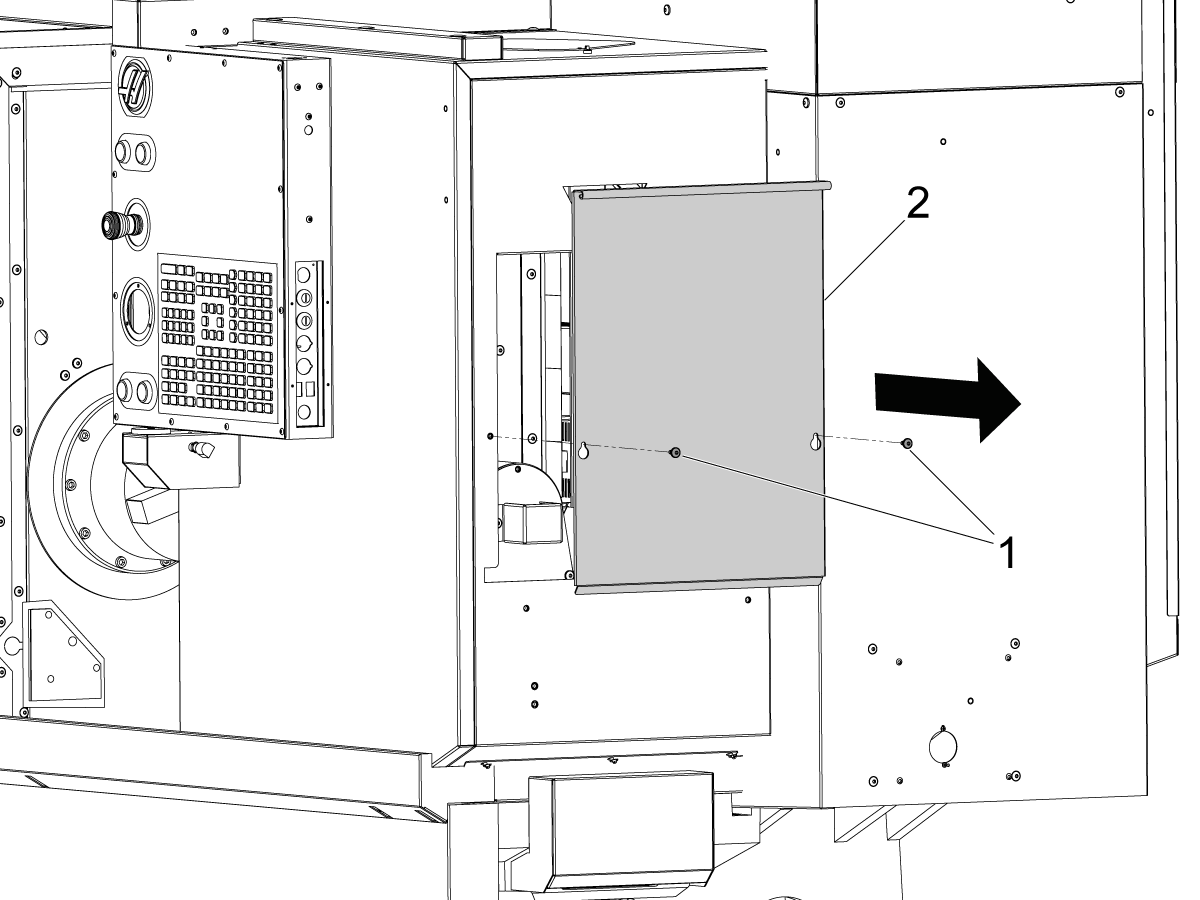

Remove access panel bolts [1] then remove side access panel [2].
Note : The chip conveyer and other miscellaneous components are hidden in this procedure for illustration purposes.

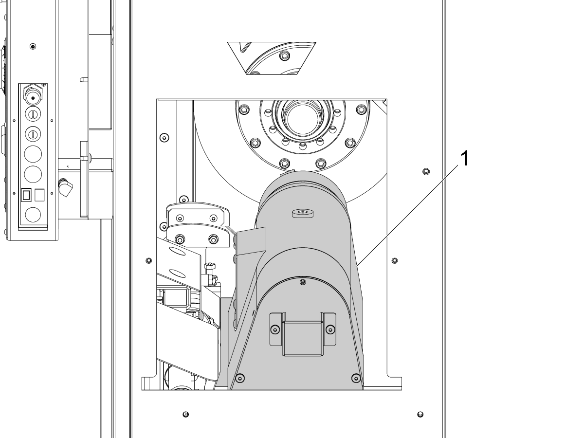

Jog the sub-spindle towards [1] the main spindle until there is adequate access to install the protection bracket then press [E-STOP]

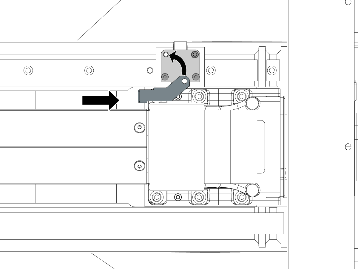

Remove the far right bolt [1] from the original home switch bracket.
Note : This bolt will be reused for the protection bracket install.
Slide the bracket along the B-axis until there is enough clearance to rotate it and align the holes.
Note : This protection bracket sits between the original switch bracket and the linear guide rail.
Important : Remove any metal chips near the home switch before installing the protection bracket.
Align the bracket by pushing the highlighted inner surface [1] against the home switch.
6
Re-install the bracket bolt [2] while holding the bracket [1] against the home switch to preserve alignment while tightening.
Important : Jog the spindle back to the home position to ensure the alignment is correct.
