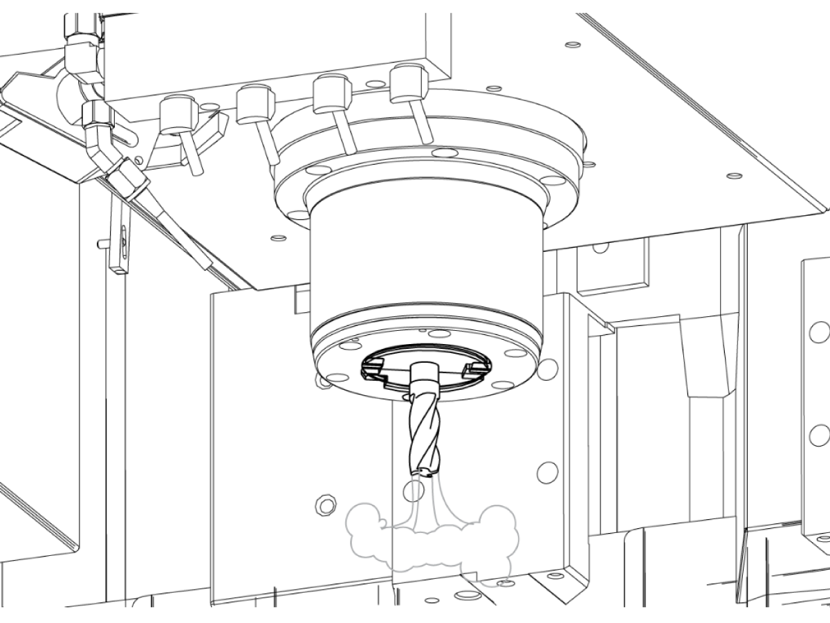

This Through-Tool Oil Mist System will atomize oil, and allow the user to blast oil infused air through tools using the Through-Tool Air Blast (TAB) system.
Note: This Through-Tool Oil Mist system requires a machine equipped with Through-Tool Air Blast (TAB). Verify the machine configuration before installation. This kit is not compatible with machines that do not meet these requirements.

Verify that the Through Tool Oil Mist Sytem operates correctly.
Insert a tool with an orifice into the spindle.
Operate this code in MDI mode:
M73;
G04 P5.;
M74;
G04 P3.;
M99;
M73 starts the TAB. M74 stops the TAB.
Manually operate the Through Tool Oil Mist System:
Press [SHIFT], Press [AUX CLNT]
The tool air blast starts.
The Oil Mist stops.
