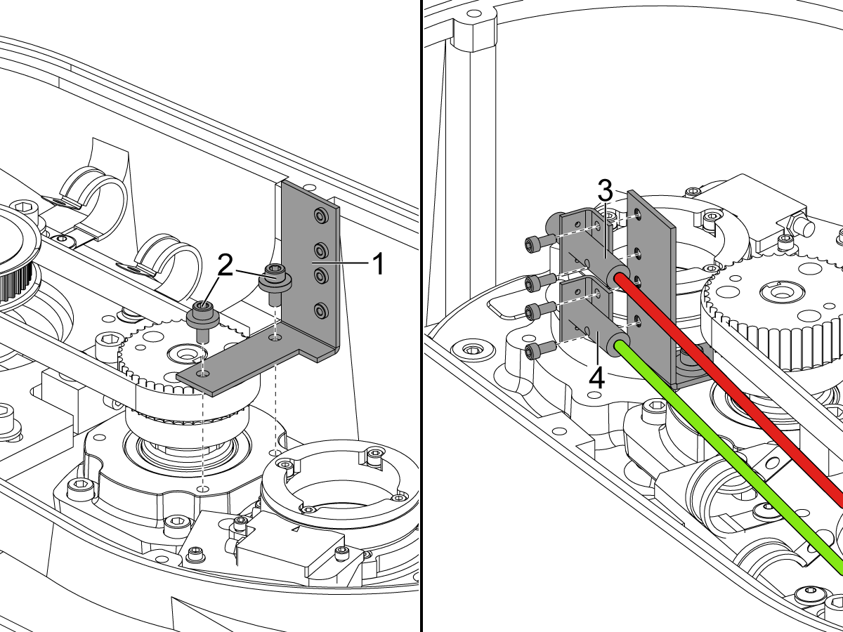

Rotate the B-axis +90 degrees and remove the cover [1]. Return the B-axis to its original position at 0 degrees.
Install the prox switch bracket [1] using its hardware [2] as shown.
Install the NC clamp sensor [3] and the NO Unclamp sensor [4] as shown.
Important: It is important that the clamp/unclamp sensors are installed in the correct locations or the pallet receiver may behave incorrectly.
