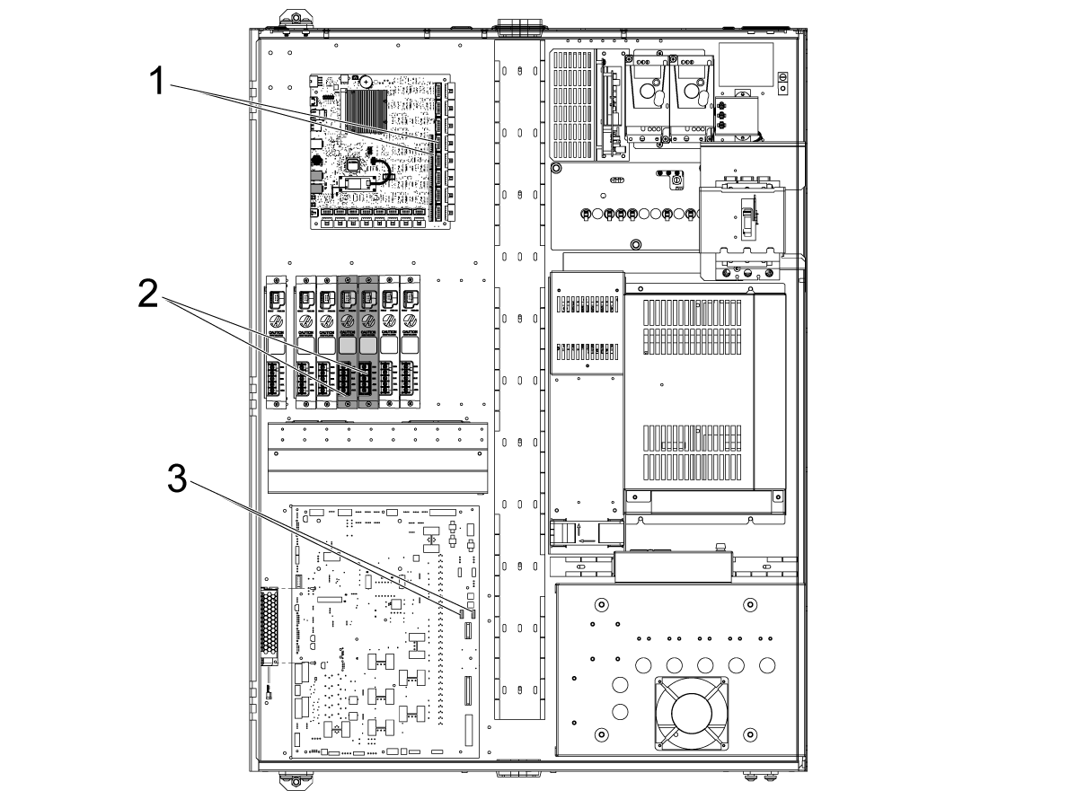

Unplug encoder switches located in P4 and P5 on the mocon [1].
Unscrew and disconnect the power amplifiers from the 4th and 5th axis power box [2]. Read the decal below the power supplies. Always verify the wires according to the markings shown below each box.
Unplug solenoid cables P16 and P17 from the I/O board [3].

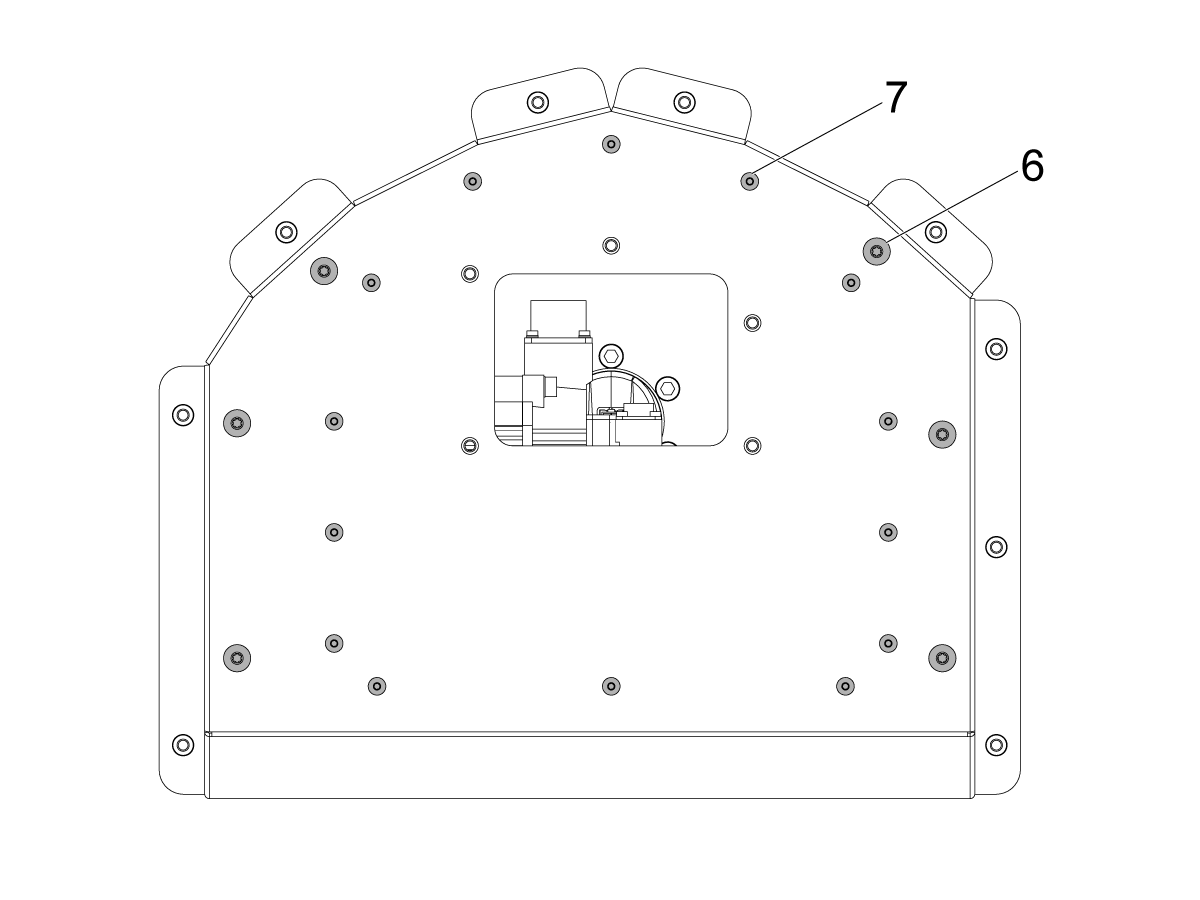

Remove TRT back cover panel (14) 10-32 BHCS [7] & (6) 1/4-20 BHCS [6].
Once the back cover is unbolted, disconnect motor power, encoders, and home switch.

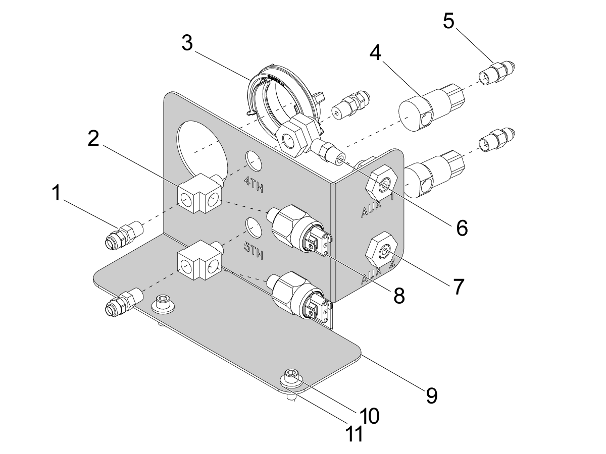

Assemble bracket as shown.
[1] 58-16706 - FITG POLY1/4F NPT1/8M STR BRASS
[2] 58-3002 - FITG GARDEN 3/4 M X 1-11 BSPT M 90
[3] 79-0036 - SPLIT CONDUIT PANEL CONNECTOR P36
[4] 58-0959 - FITG 1/8-27NPTF 1/8-27NPTF 90 SWIVEL
[5] 58-3082 - FITG JIC3M NPT1/8M STR STL
[6] 58-16732 - NIPPLE 1/8 NPT X 1 HEX BRASS
[7] 58-2021 - FITG NPT1/8 X DIA .625 X .96 BKHD BRASS
[8] 53-0020A - PRESSURE SWITCH 4PSI NO ROTARY
[9] 25-17646 - BRKT PRESS SWITCH Y-AXIS RT UMC-400
[10] 40-2000 - SHCS 1/4-20 X 5/8 ZINC PLATED
[11] 45-0040 - WASHER FLAT SAE 1/4 ZINC PLATED

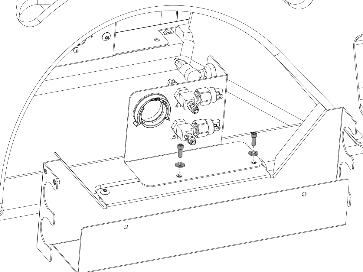

Remove the two farthest right FBHCS 1/4-20 x 1/2 and Install the bracket using (2) SHCS 1/4-20 x 5/8 as shown.

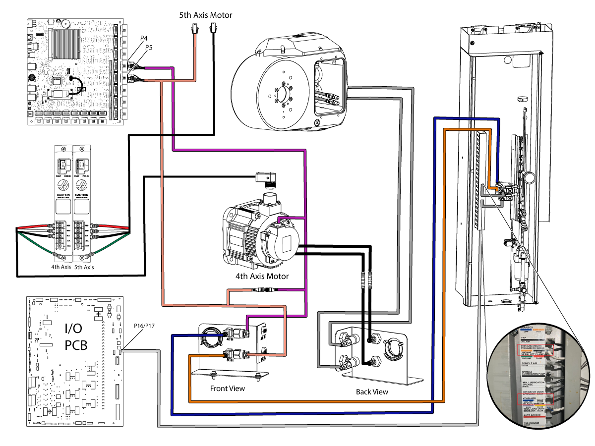

Connect the home switch and remaining molex connectors. Use the schematic below to verify locations.
Service Tip: If your machine has a Zero Point Kit installed, you must disconnect the steel braided auxiliary lines that are connected to the original box and reconnect them to the new bracket. These airlines are connected to solenoids in the lube cabinet.
9
Below is a full schematic showing connections in order to complete kit installation.

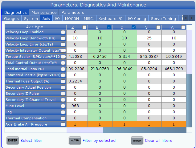

Verify that the system is working properly by actuating the B & C axis brake several times.
Go into Diagnostics -> Axis, then scroll over to the B & C Axis and all the way down to Axis Brake Air Pressure, to confirm that the pressure switch bit is changing.
