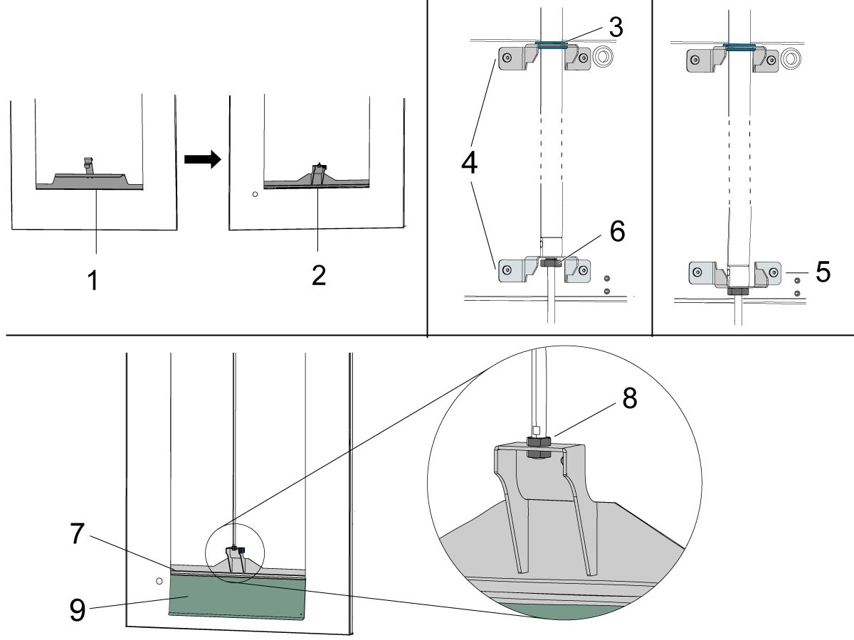

Use a putty knife to remove SikaFlex and separate the original window bracket [1] from the window. Clean bottom of window.
Add SikaFlex inside the new window bracket [2] to attach to the same window. Make sure the cylinder's hole in the window bracket [2] is aligned with the center of the window.
Insert grommet [3] inside its corresponding bracket [4]. Bolt both brackets [4] to the enclosure above the window.
 IMPORTANT: UMC-500's lower bracket [4] is installed in the same orientation as the upper bracket whereas UMC-400 and UMC-750 to 1500's lower bracket [5] is installed in the flip orientation by 180 degrees.
Remove bottom nut [6] on the cylinder to slide it through both brackets [4]. Install the bottom nut [6] to secure to the cylinder.
Insert bottom of cylinder shaft through the window bracket's [7] hole and secure with jam nuts [8].
Slide the window drip cover [9] into the groove in between the window bracket [7] and enclosure.

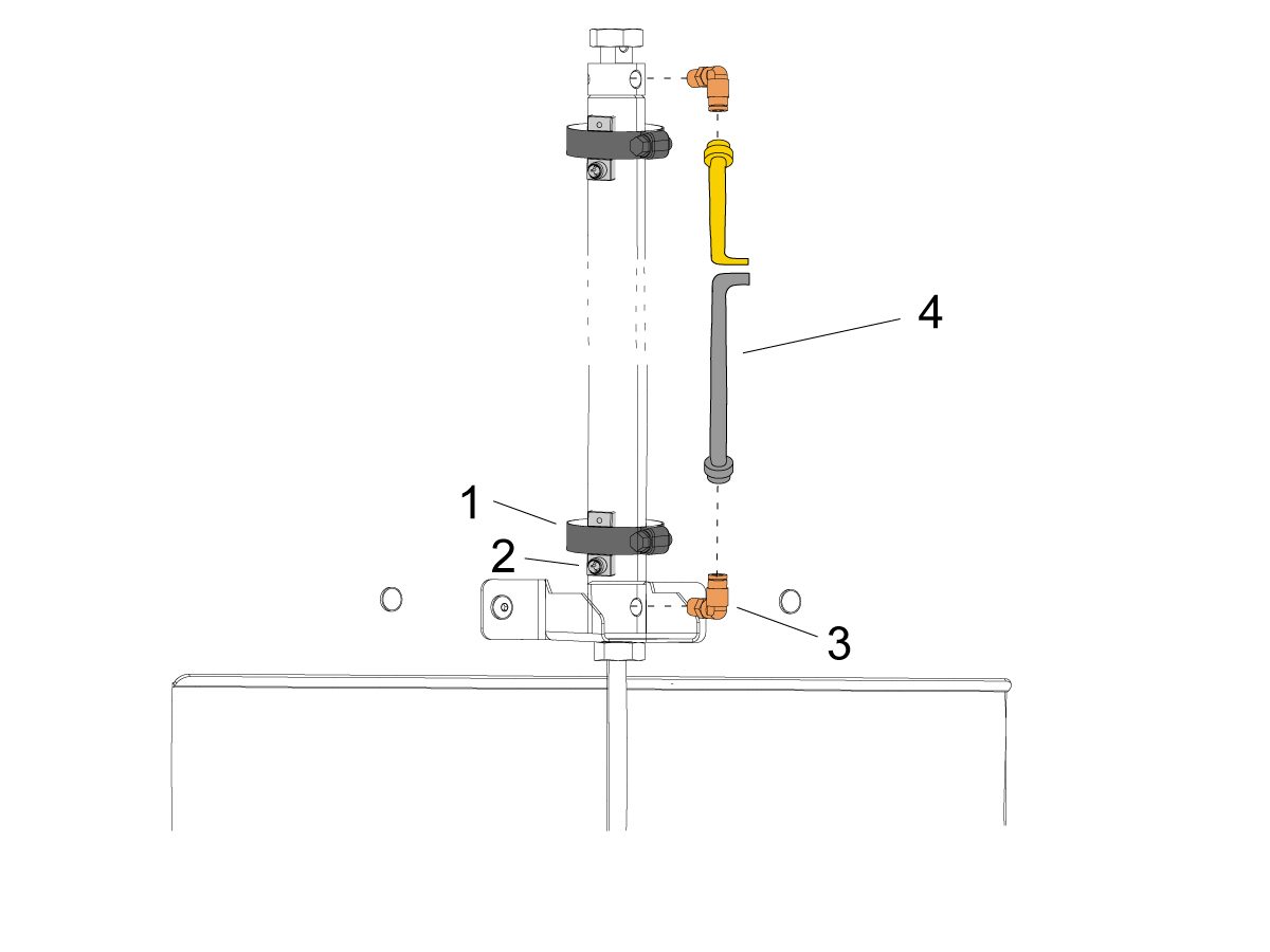

Loosen the sensor clamp [1] until the opening is wide enough to fit around the cylinder. Place one clamp around the bottom of the cylinder and the other around the top.
Insert sensor [2] in between clamp and cylinder. Tighten the sensor clamp [1].
Attach two hose fittings [3] to the bottom and top of the cylinder.
Connect the gray airline [4] to the bottom hose fitting on the cylinder and connect the yellow airline to the top hose fitting on the cylinder.  This line gets filled with air to push the door down.

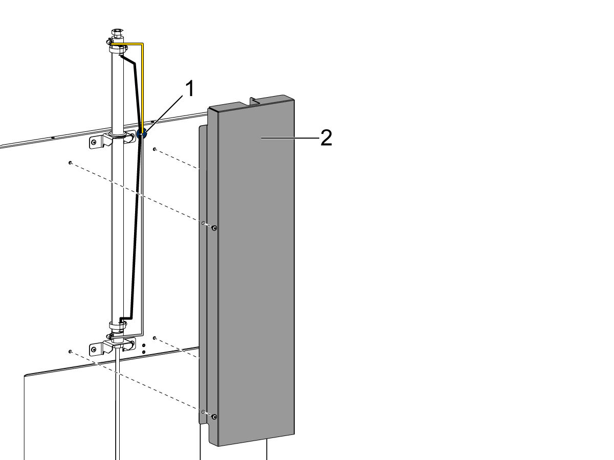

Connect and route both sensor wires and airlines into the enclosure hole [1].
 Important: Move any wires and hoses around to prevent any kinks or rubbing before the enclosure cover is put on.
Secure both airlines and sensor cable to the cylinder with zip ties.
Bolt enclosure cover assembly [2] to the machine's enclosure above the window.
 NOTE: No need to bolt enclosure cover [2] yet as the clamp sensors will need to be aligned in the Clamp Sensor Alignment section below.

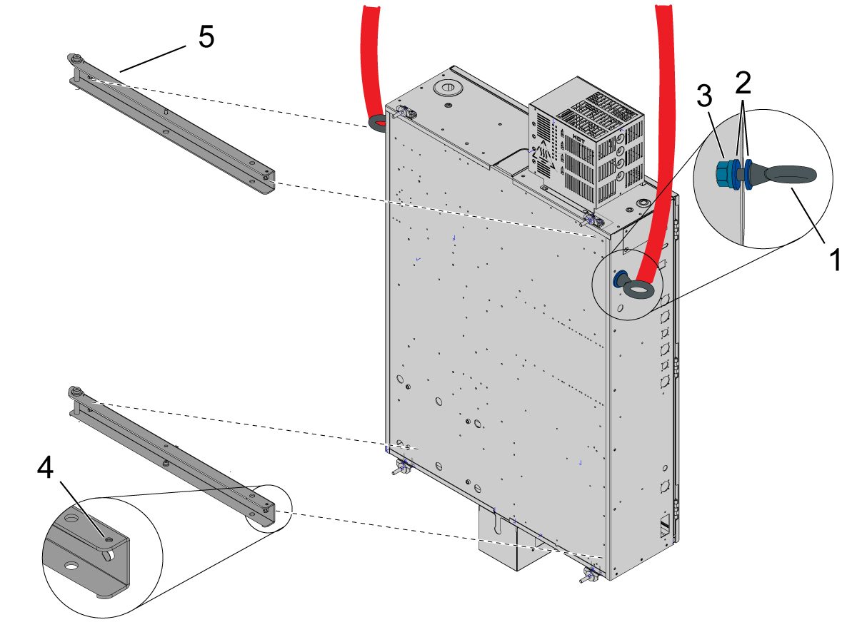

Place one strap horizontally underneath [1] the control cabinet and the other vertically underneath [2] the control cabinet. Attach both straps to forklift.
Slowly lift the control cabinet unit the weight of the cabinet is fully supported.
Remove bolts connecting control cabinet to machine.
While the control is floating, install mounting brackets [4] to the back of the control cabinet. Slightly loosen the vertical strap [2] as needed to expose the back of the control cabinet while continuing to support the cabinet to prevent tipping over.
 NOTE: Make sure the small corner cutout [3] in the bracket [4] is facing up.
Alternative Lifting Method:
Remove the circular plug inserted in either side of the control cabinet enclosure.
Install an industrial grade shoulder eyebolt 1/2 - 13 x 1.50 x 1.19 [1] and washer [2] through both control cabinet cutouts. From inside the machine, install another washer [2] and lock nut [3].
Place straps through each eye bolt loop. Attach both straps to forklift.
IMPORTANT: Due to the control cabinet cutout's being at different heights, the straps will need to be adjusted to be level. Make sure the cabinet is square before lifting.
While the control is floating, install mounting brackets [5] to the back of the control cabinet.
 NOTE: Make sure the small corner cutout [4] in the bracket [5] is facing up.

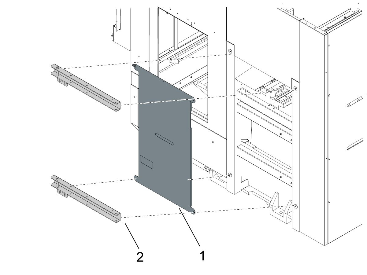

Remove the machine's side panel enclosure.
Install the control cabinet cover [1] to the side of the machine.
Install pivot braces [2] on top of the control cover [1].
Align the control cabinet cover [1] and pivot brace's [2] corner holes. Bolt to the machine.
6
Slowly lift the control cabinet [1] over to the side of the machine.
Slide the mounting brace on the back of the control cabinet [1] into the pivot brace on the machine [2]. Align both braces.
Insert shoulder bolt [3] through both brace's corner cutouts.

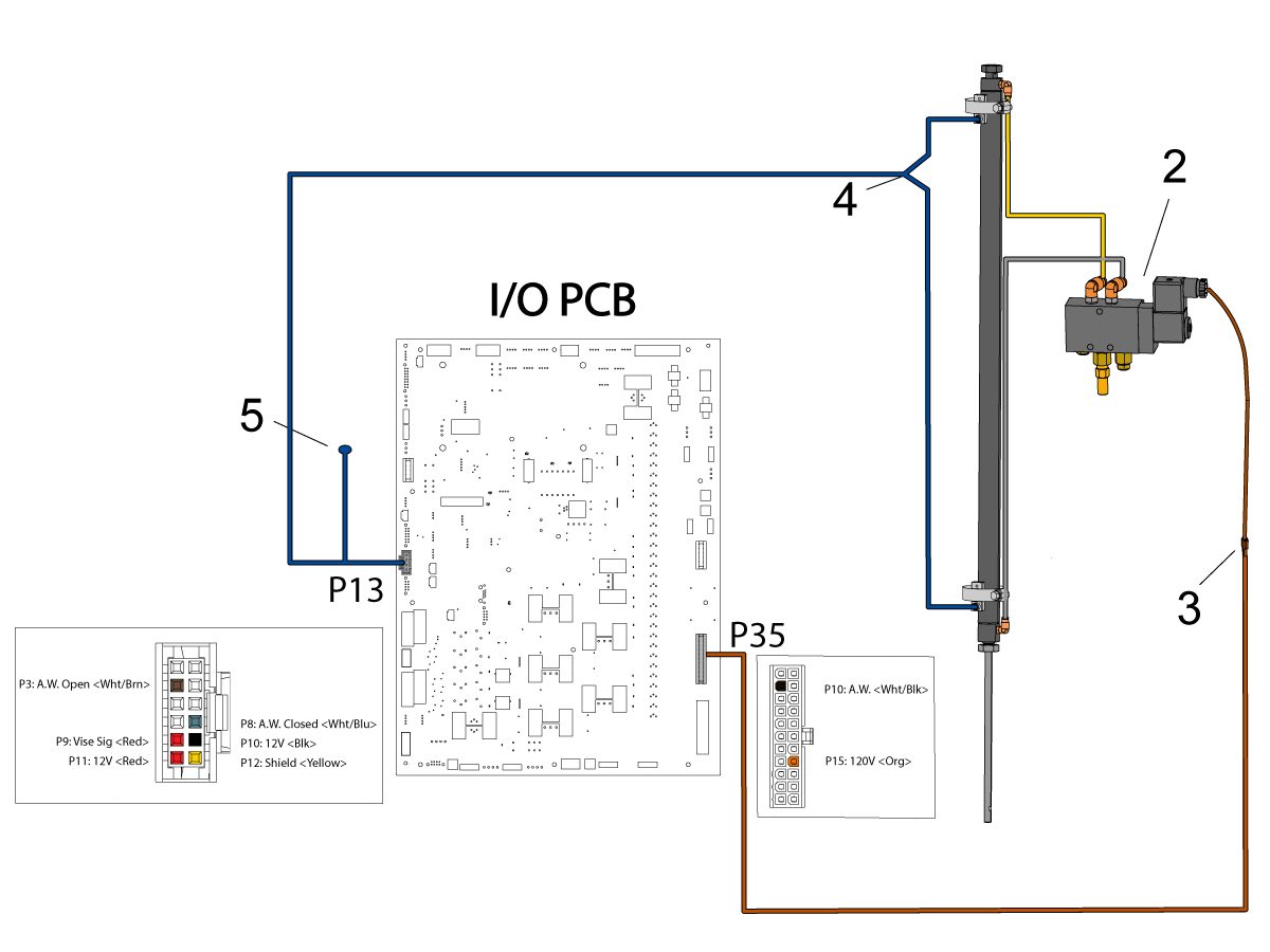

Inside the CALM cabinet, remove and discard the manifold plug [1]. Clean the port threads on the manifold.
Install the solenoid assembly [2] into the manifold port. Connect corresponding yellow and grey hosing to the solenoid's fitting.
 Note: Refer to the Air-Lubrication System decal inside the lubrication cabinet for correct solenoid placement.
Connect the Auto Window solenoid power cable [3] to the connector labeled UMC Auto Window on the terminal bracket.
 Note: The Air/Lube Solenoids cable 33-9085F is shown for reference.
Extension cable 33-0521C [4] connects to P13 on the IOPCB and to the open and close sensor's connector. If the machine is equipped with other add-on options, remove the cable from P13 and connect it to the pigtail cable [5].
UMC Series:
After routing the wires and airlines through the enclosure hole, run the yellow [1] and gray [2] airlines down the side of the enclosure to the conduit holder on the back of the base. Continue to route them up the other side of the enclosure and into the lube cabinet.
Route the sensor cables [3]down the side of the enclosure and through the C-channel bracket down into the control cabinet.
