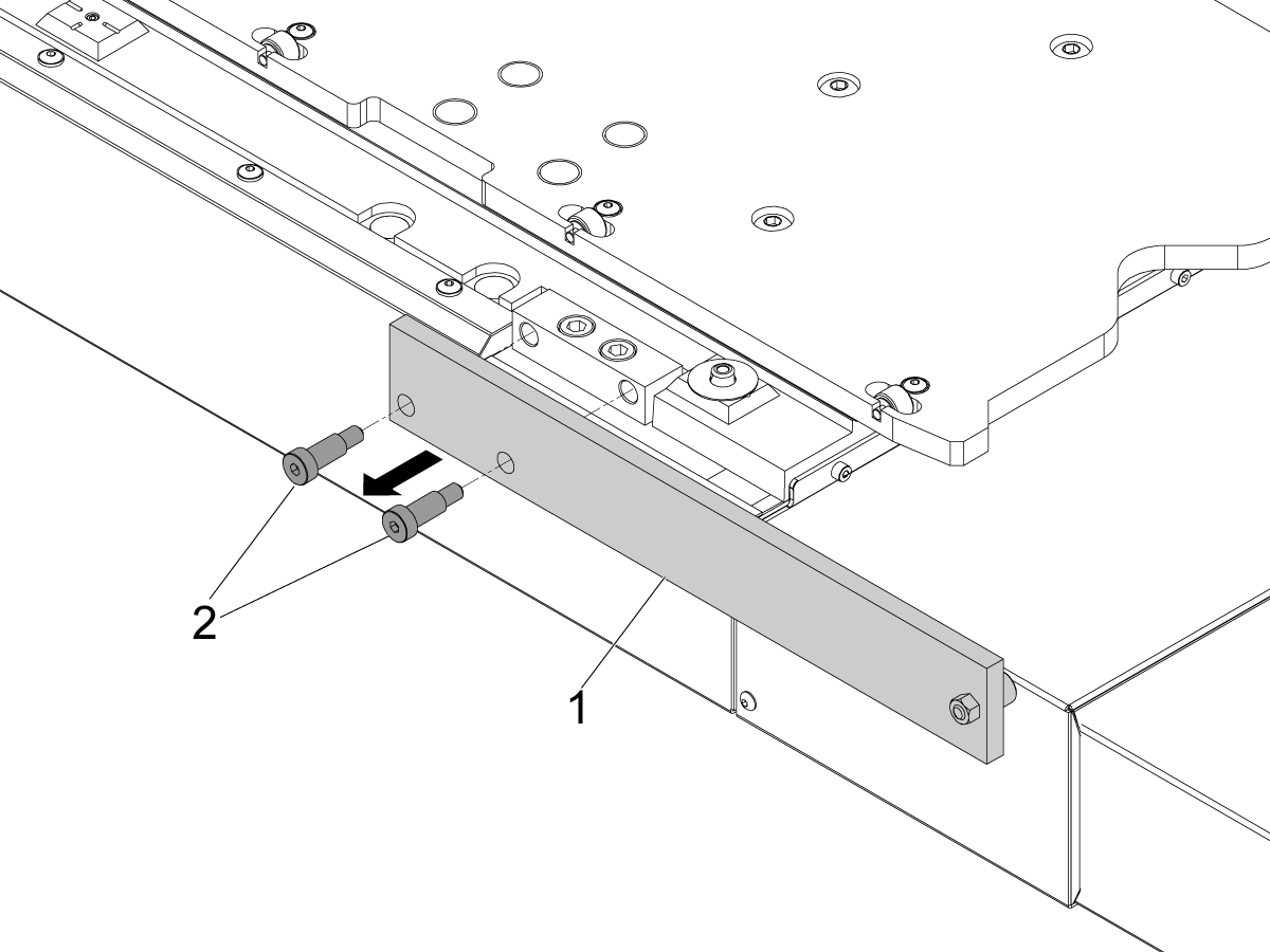

This procedure will tell you how to replace the bridge arm/probe support block for a VF-4 Pallet Pool. This replacement kit allows for alignment of the bridge arms and probe mount.
This procedure applies the following kits:
  • 93-4756 BRIDGE SUPPORT BLOCK SERVICE KIT VF-4PP
Replacement
Remove the bridge arm [1] from the support block by taking out the 1/2 inch diameter shoulder bolts [2].
Remove the support block [1] from the table by removing the two 1/2-13 socket head cap screws [2].
Attach the new support block [1] to the table using the two 1/2-13 flat head cap screws [2].
Reattach the bridge arm/probe mount arm [1] by using the 1/2 diameter shoulder bolts [2] from earlier.
Important:  When reinstalling the probe mount arm, the OTS probe for the WIPS will need to the be indicated and recalibrated to ensure that tools are correctly probed into the machine. Refer to the WIPS - Probe Calibration - NGC - AD0382 to indicate and recalibrate the probe.
