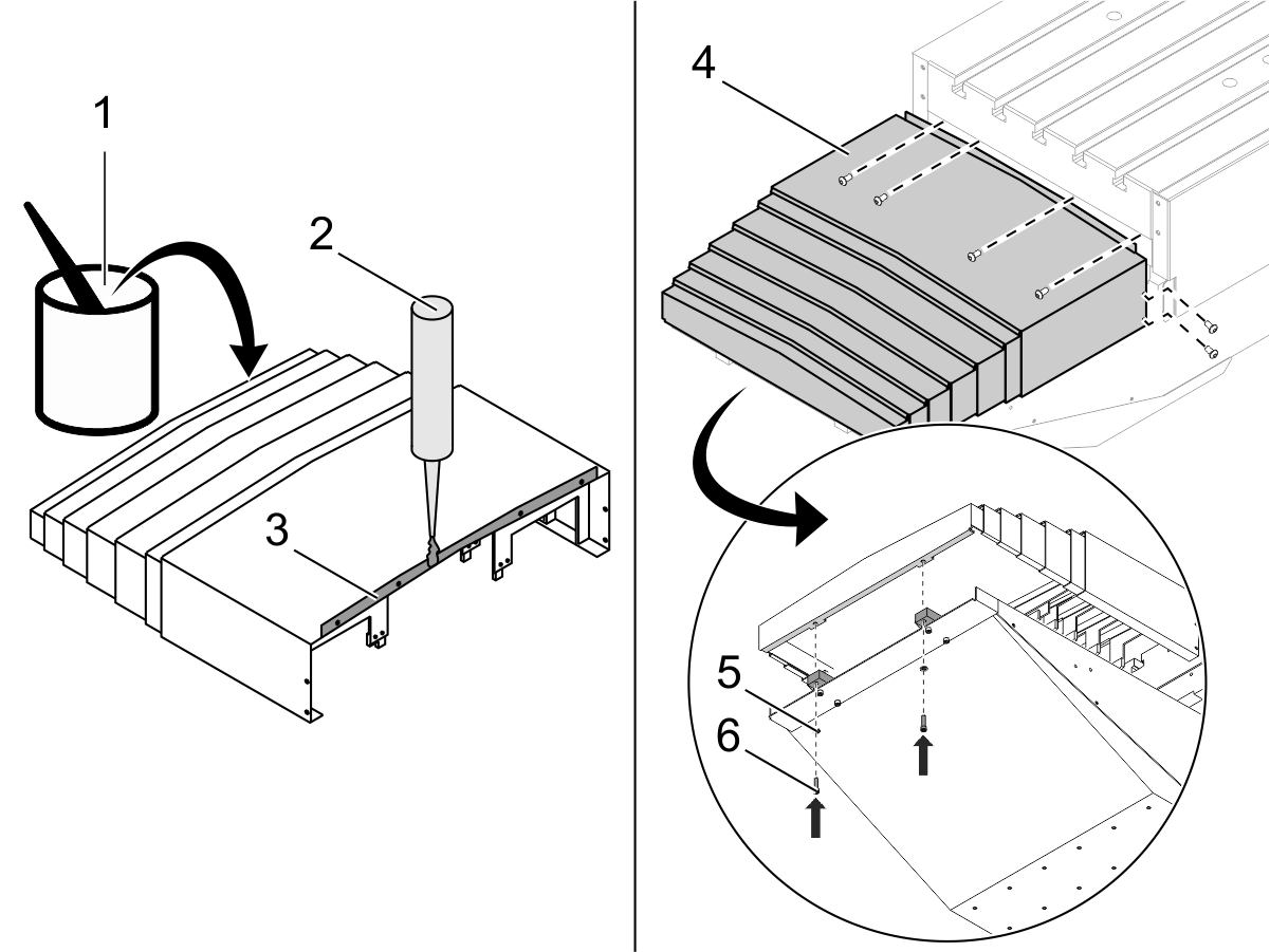

Waycover Replacement
Parts Included: 93-20023 (for VF3YT/50) or 93-20022 (for VF-4/5).
Tools Required: P/N 99-4520A (Red-I Greases) and P/N 99-4465 (RTV Sealant).
Remove the X-Axis way cover, L-bracket, and the guide bars.
Install the replacement guide bars [2] and the guide bar covers [1].
For VF-4/5 machines only:
Install the extension panel [A], (4) washers [3], and the (4) socket-head cap screws (SHCS) [4].
Apply Red-I grease [1] to the replacement way cover.
Apply the RTV sealant [2] to the flange [3] on the replacement way cover.
Install the replacement way cover [4], (2) washers [5], (2) SHCS [6].
