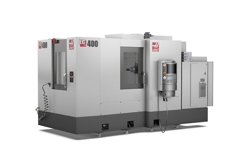

This reference document is meant to help identify between a pre-reboot EC-400/500/630 and reboot EC machine.  This document cannot be used for EC-1600's.
Reboot machines parts will not be backwards compatible with pre-reboot machines and were built after the following dates.
  • EC-400: Built after 07/2017
  • EC-500: Built after 10/2019
  • EC-630: Built after 07/2021
NOTE: Pictured is an EC-400 but this identification guide will apply for the EC-500 /630 as well.
Identification
The pre-reboot 4th axis [1] has more of a dome shape to both the receiver [3] and saddle [4].  The reboot machines [2] have a slightly dome style to the receiver [3] but the saddle [4] is flat.
This will be the main way to identify between a reboot and non reboot machine as much of the appearance are the same.
