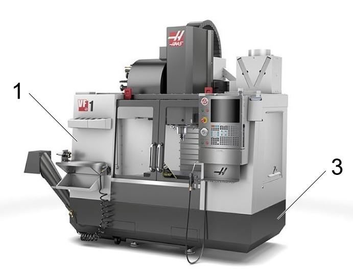

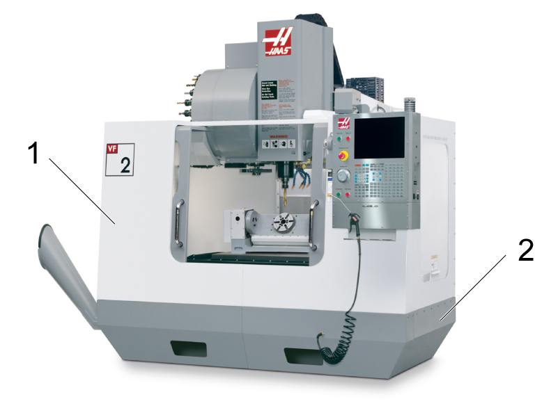

Haas Touch Up Paint Color Codes
Paint Colors RAL Color Code Notes:
Light Gray [1] RAL 7035 Used for all machines
Dark Gray [2] RAL 7042 Used for machines built before 2010
Premium Gray [3] RAL 7015 Used for machines built after 2010
