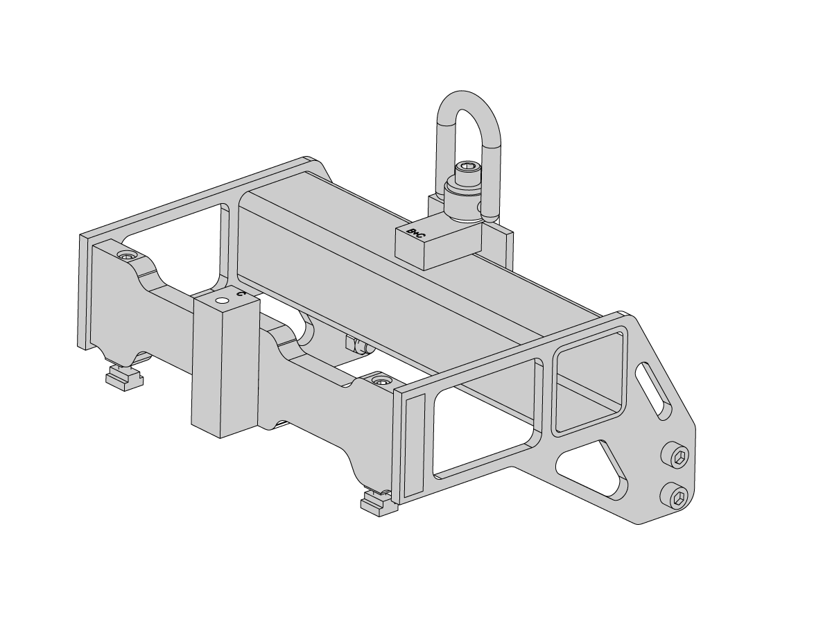

TOOLING
T-2194 - UMC Rotary Axis Lifting Tool: 65 lbs
(compatible for both Pre-Re-boot and Re-Boot style Units)

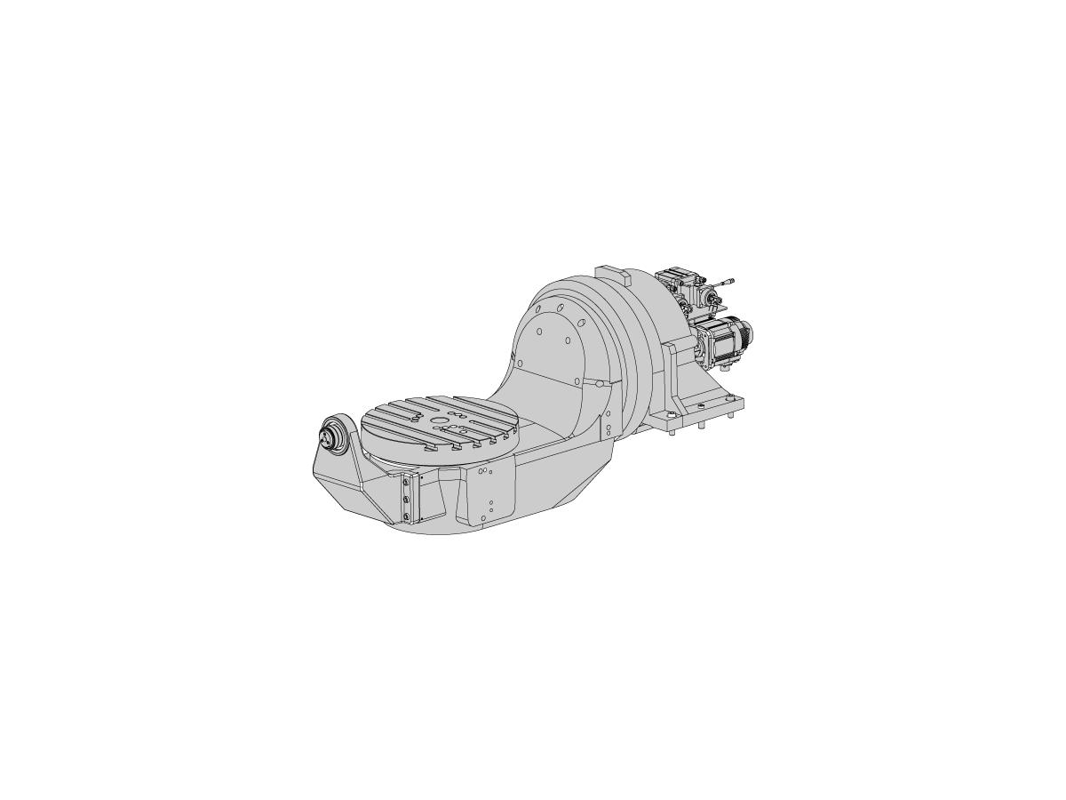

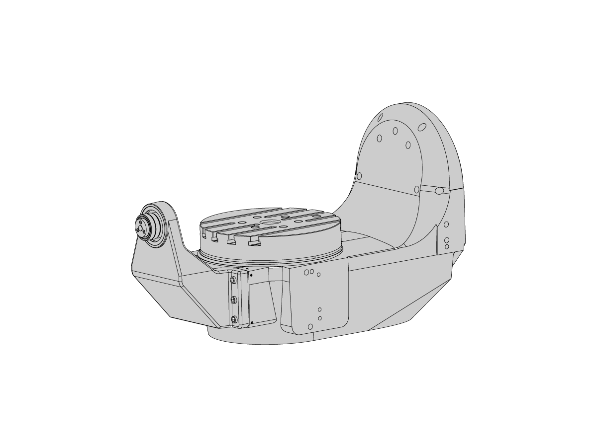

UMC-750/SS Rotary Unit (2016 and prior)
UMC-750 B/C Rotary Unit: 1,750 lbs
UMC-750SS B/C Rotary Unit: 2,350 lbs

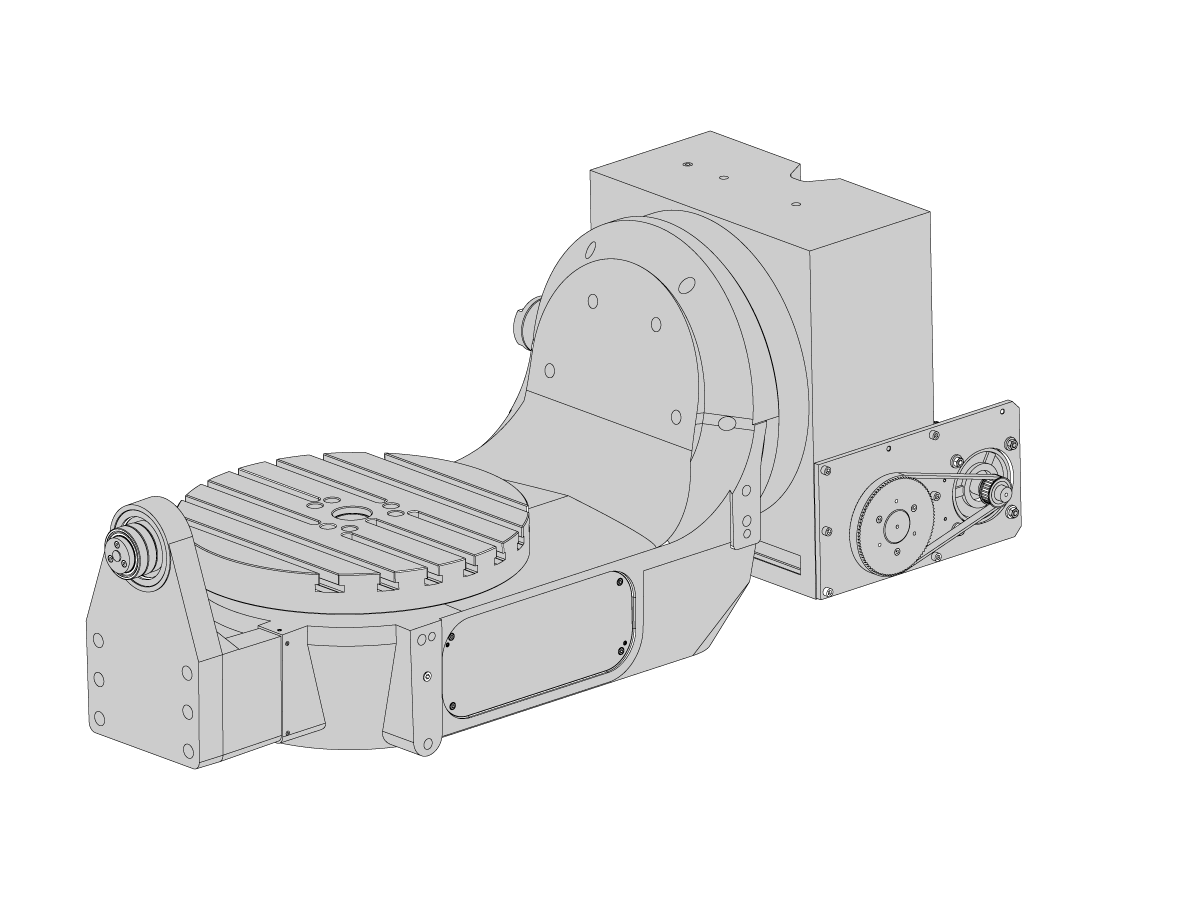

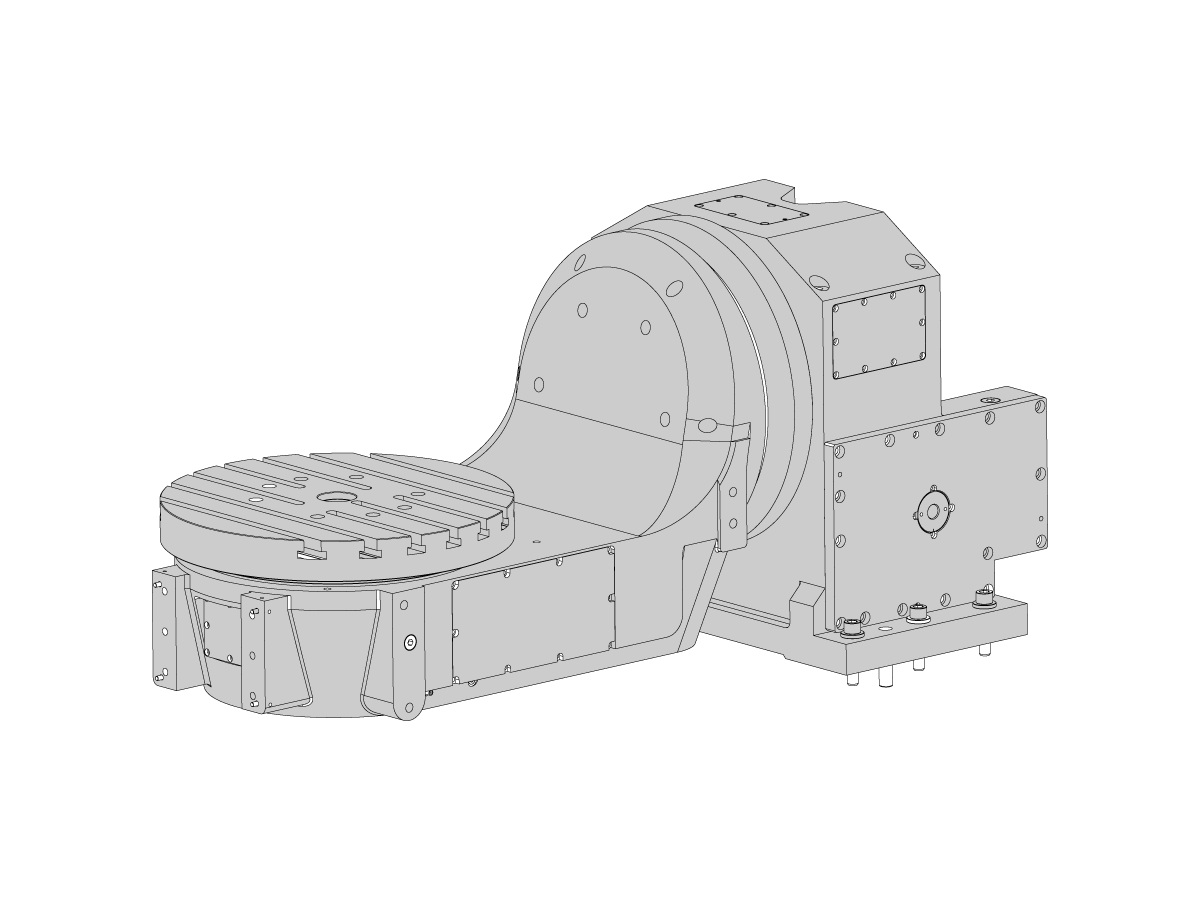

UMC-500/SS/PP / UMC-750/SS/PP / UMC-1000/SS/PP / UMC-1250/SS/PP (2017 to current)
Rotary Unit with T-Plot Platter
UMC-500/500SS: 1350 lbs
UMC-750/750SS: 1600 lbs
UMC-1000/1000SS: 1700 lbs
UMC-1250/1250SS: 1650 lbs
C AxisRotary Unit with T-Plot Platter
UMC-500/500SS: 800 lbs
UMC-750/750SS: 900 lbs
UMC-1000/1000SS: 1000 lbs
UMC-1250/1250SS: 1150 lbs

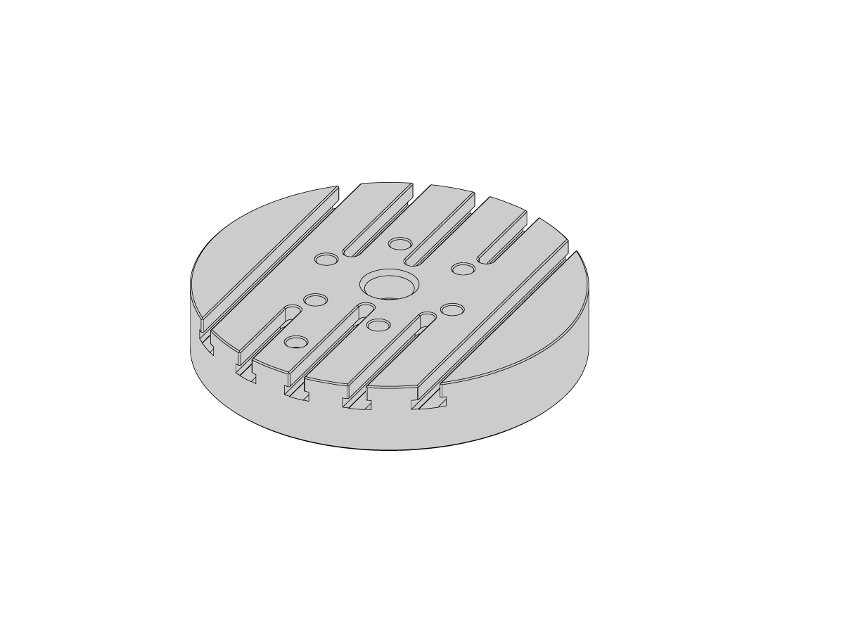

Platter Option (2017 to current)
T-Plot Platter
UMC-500/500SS: 100 lbs
UMC-750/750SS: 175lbs
UMC-1000/1000SS: 250 lbs
UMC-1250/1250SS: 375 lbs

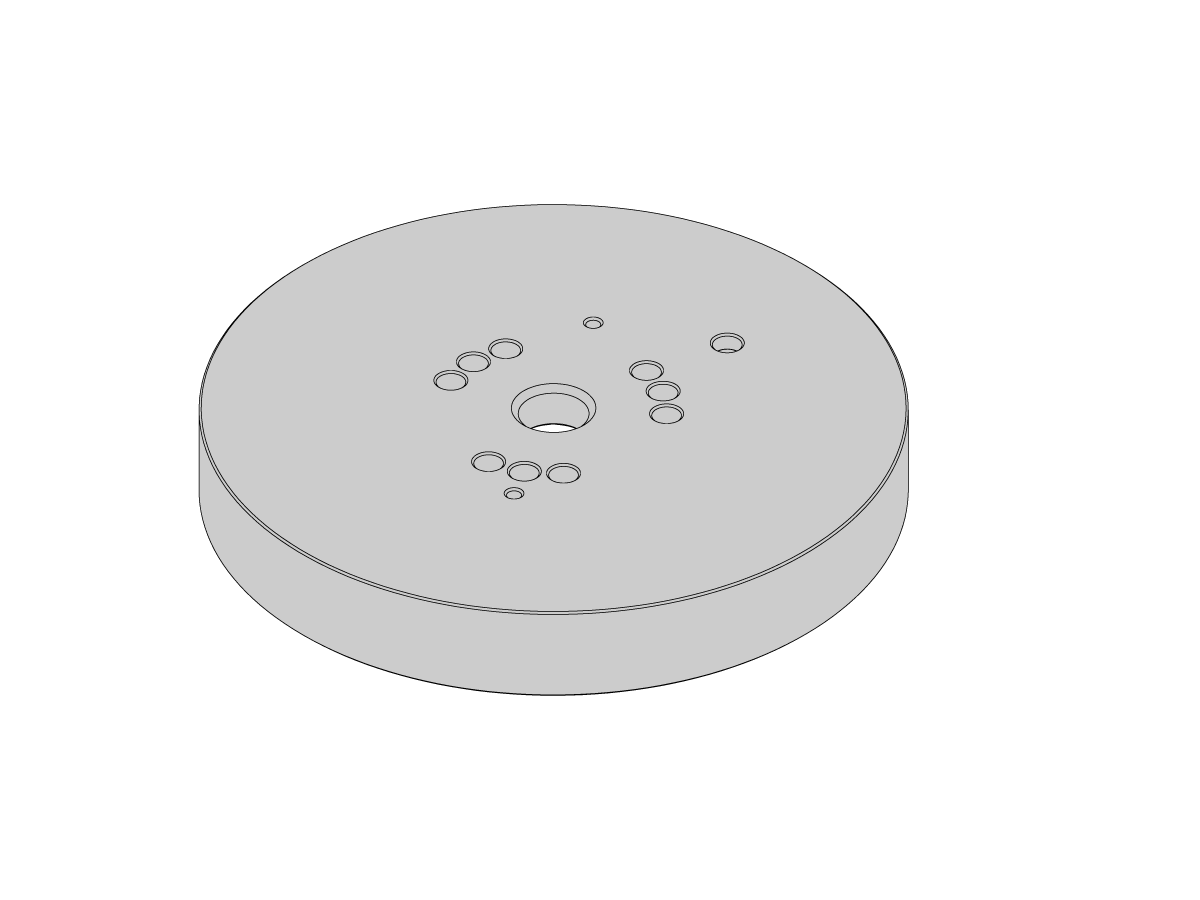

Blank Platter
UMC-500/500SS: 120 lbs
UMC-750/750SS: 200 lbs
UMC-1000/1000SS: 275 lbs
UMC-1250/1250SS: 420 lbs

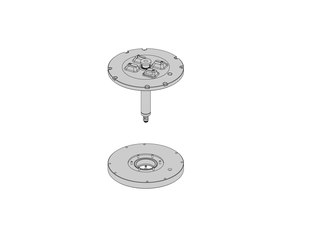

Pallet Pool Receiver and  Platter
UMC-500/500SS
Receiver: 65 lbs
Platter: 65 lbs
UMC-750/750SS
Receiver: 70 lbs
Platter:: 65 lbs
UMC-1000/1000SS
Receiver: 70 lbs
Platter:: 65 lbs
UMC-1250/1250SS
Receiver:  103 lbs
Platter:: 80 lbs
