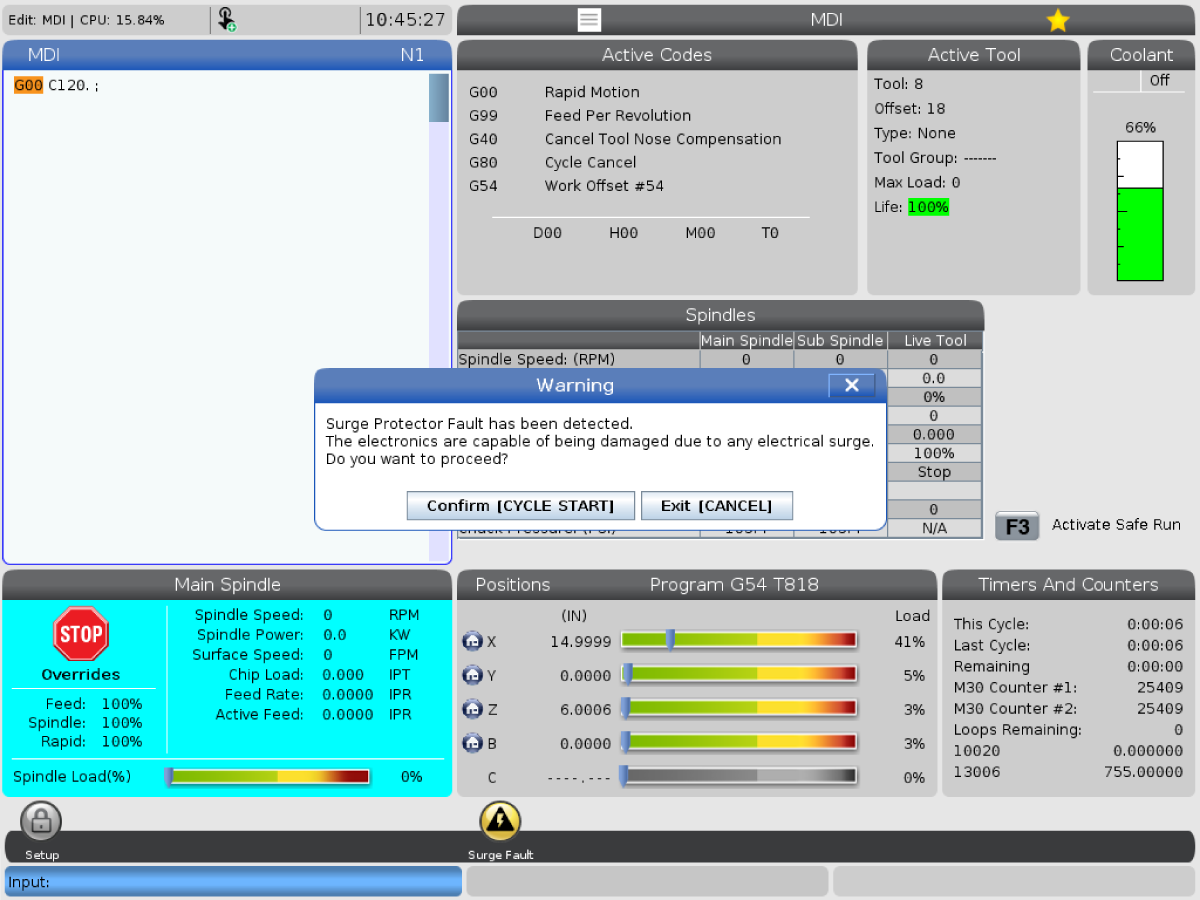

  • If Input 27 is a 1, the LED Status Light is Red, and the Surge Protector Icon is displayed. A Pop-Up will display when a program is run by pressing [CYCLE START].
Surge Protector Fault has been detected.
The electronics are capable of being damaged due to any electrical surge.
Do you want to proceed?
Press [CYCLE START] to continue or [CANCEL] to Exit.
  • Alarm 9000 is generated when Input 27 is a 1 only at power up. The alarm is resettable but if Input 27 stays a 1, the LED status light is red and the Surge Fault icon is displayed. The machine is no longer protected in the event of an electrical surge event. The machine electronics are capable of being damaged.

Surge Protector Fault Detected Pop-Up
