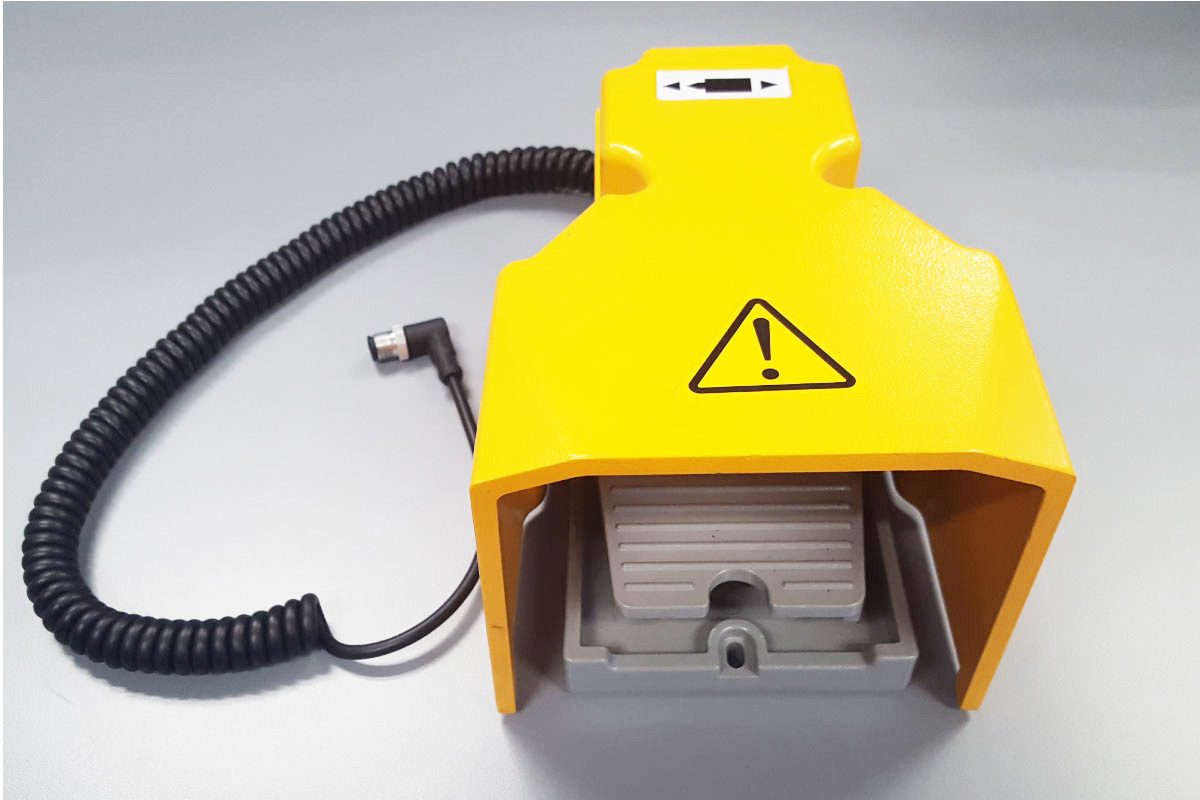

We have seen a few foot pedals returned to Haas that could have been fixed in the field.
If the foot pedal is not working.  One possible cause is the metal swtich flag not actuating the micro switch.   Use the Foot Pedal Troubleshooting Guide to learn how to adjust the metal switch flag on the foot pedal.
