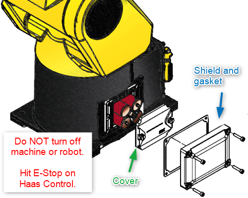

The Fanuc robot arms do not have a home switch; therefore, they rely on an absolute encoder to keep track of its current position. The encoder is powered by (4) size C industrial batteries.

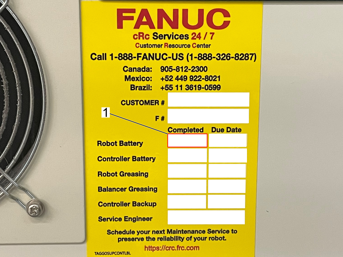

Fanuc recommends that for active application robots, change the batteries once a year. If the robot is powered down or stored long term, the batteries should be inspected every 7 months. Refer to the Fanuc service decal on the control box for the date [1] that the batteries were installed.
It is important to be on a schedule for changing batteries because if the batteries die, the robot will no longer know its position and will have to be remastered.
When changing the batteries, DO NOT turn off the robot or the Haas machine. If either are turned off when the batteries are removed, the robot will lose its data and need to be remastered.
Follow the HRP – Battery Replacement procedure to replace the batteries.
The machine will generate alarm 9156.062 when the batteries have died. If the batteries have died or the machine and/or robot have been turned off when removing the batteries, follow the HRP – Quick Mastering procedure after changing the batteries.
