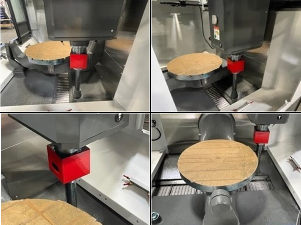

The UMC-1250 will no longer have the Z-axis blocked on top of the platter. Instead it will be blocked using the same post used for the OTS sensor as shown in the image below. Please do not throw this post away as it will be used to install the OTS sensor.
