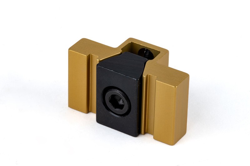

1/2" Bearbeitbare Uniforce-Klemme, von Mitee-Bite
Teilenummer: 05-0433
MACHINABLE UNIFORCE CLAMP 500
Preis: 16.95 ( / Einheit)
  • Technische Dokumente
Clamp Series Uniforce Clamp
Edge Type Machinable Edge
Material Tool Steel, Aluminum
[A] Dimension 1.125 in
[B] Dimension 0.5 in
[C] Dimension 0.62 in
[D] Dimension 0.42 in
[E] Dimension 0.25 in
[F] Dimension 0.18 in
[G] Dimension 0.4 in
[TP2] Thread #2-56
[TP1] Thread #8-32
Maximum Torque 2.5 ft-lb
Holding Force 500 lbs
Country of Origin USA
