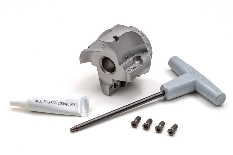

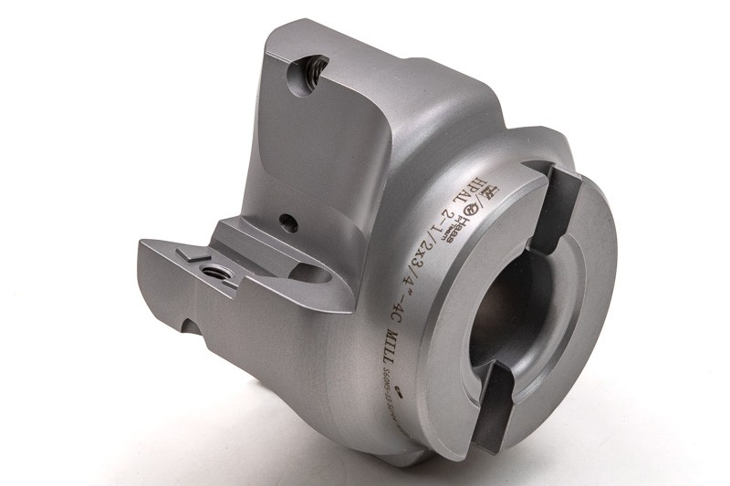

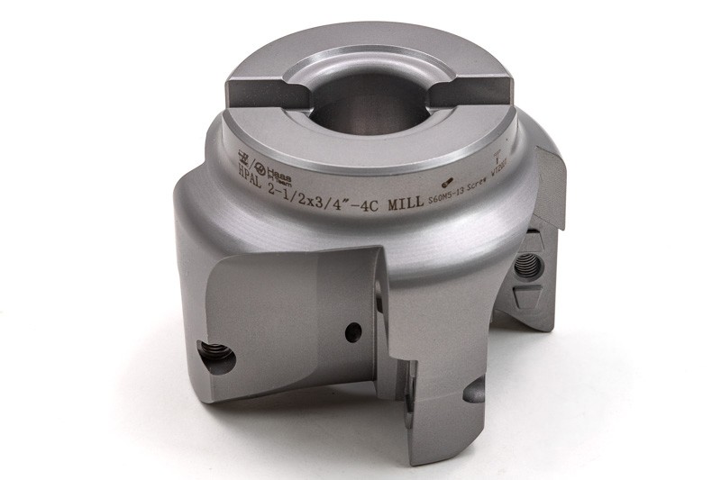

HPAL2, 2-1/2 Zoll Ø Werkzeughalter für Plan- und Eckfräser, 3/4-Zoll-Führungsbohrung x 90 ° Steigungswinkel, 4 Schneiden, positiv/positiv Geometrie, TSC
Teilenummer: 01-0780
HPAL 2-1/2 x 3/4"-4C SHL MILL
Preis: 251.95 ( / Einheit)
This Haas High Positive Aluminum (HPAL2) coarse-pitch shell mill is specially designed for heavy machining of aluminum and similar n on-ferrous materials, while maintaining a good surface finish. The concave grooves found on the back of its inserts provide for strong clamping at higher cutting speeds, and the buffed cutting surfaces ensure smoother chip evacuation and reduced built-up edge (BUE) when copy milling, face milling, helical milling, ramping, shoulder milling, and slotting. It has a 2.5 in \ 2.5" cutting diameter, and a 3/4" pilot bore, with a 90-degree cutting edge. The positive axial, positive radial-raked cutter body takes 4 polygon/special cutting inserts. The screw-clamp inserts have 2 cutting edges, and are available in grades for aluminum/non-ferrous materials. This cutter body is through-tool coolant (TSC) capable, when used in conjunction with a coolant-through arbor screw. Inserts and coolant-through arbor screw sold separately.
Messsystem Inch – ANSI
[ØDC] Zerspanungsdurchmesser 2,5 Zoll \ 2-1/2″
Fräserserien HPAL2 – Haas HP Aluminum
Art der Werkzeugbahn Rampenfräsen, Wendelfräsen, Planfräsen, Schulterfräsen, Schlitzen, Kopierfräsen
[°] Voreilwinkel 90 Grad
[Z] Anzahl der Zerspanungszähne 4
[Ød] Wellenbohrungsdurchmesser 0,75 Zoll
[a] Keilnutbreite 0,313 in
[Ap] Max. Zerspanungstiefe 0,862 Zoll
[OAL] Gesamtlänge 2,0 Zoll
[IC] Beschrifteter Kreisdurchmesser 0,502 Zoll/12,76 mm
[L10] Länge der Schnittkante 0,862 Zoll/21,9 mm
Maximale U/min 8000
Anzugsmoment der Einsatzschraube 1020 Ncm
Kopplungsart A
Durch Werkzeug-Kühlmittel Ja
Gewicht 0,5 lb \ 0,2 kg
Ursprungsland China
